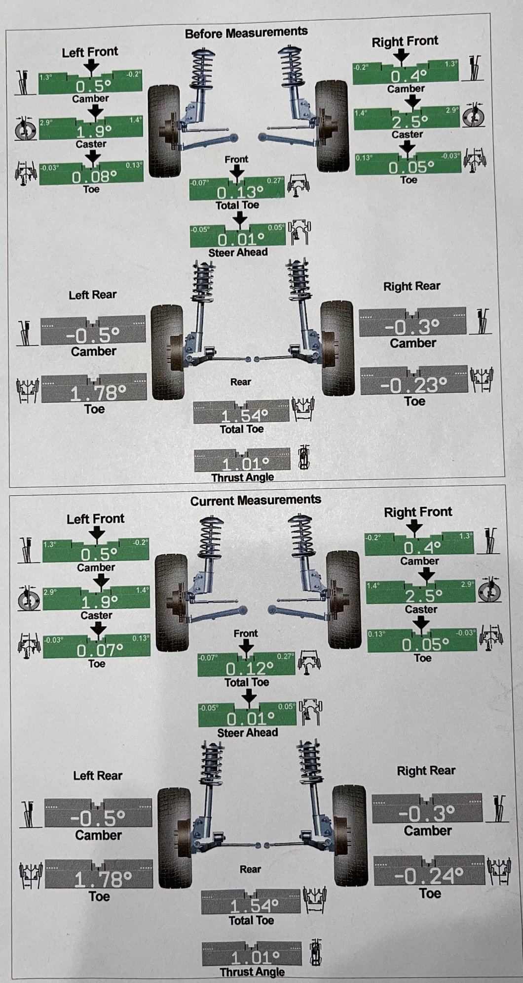

I took it to an off road shop near me yesterday and they checked it out. The driver rear is positive toe 1.78 degrees while the passenger rear toe is -0.24…. Diagnosis is a bent axle…. It is a restored title, and we checked the vin on google to see the accident that totaled it, and it was hit hard on the driver rear pushing the axle forward. They must’ve replaced all the suspension and not spent much time checking(or caring about) the driver rear toe.. of course they had it inspected, and I hear that protects them from liabilities like these. Does anyone know if that’s true? Or do I have a leg to stand on for getting the dealer to replace the axle? I’ve had it for 2.5 or so years.
so that shop is quoting me $2,500 for a used axle off a Tacoma that is totaled from a front end collision with 66k miles(mine has 27k miles) with a 12k mile 12 month warranty. Total after labor and tax is $3,700 to replace the axle. Does this sound reasonable?

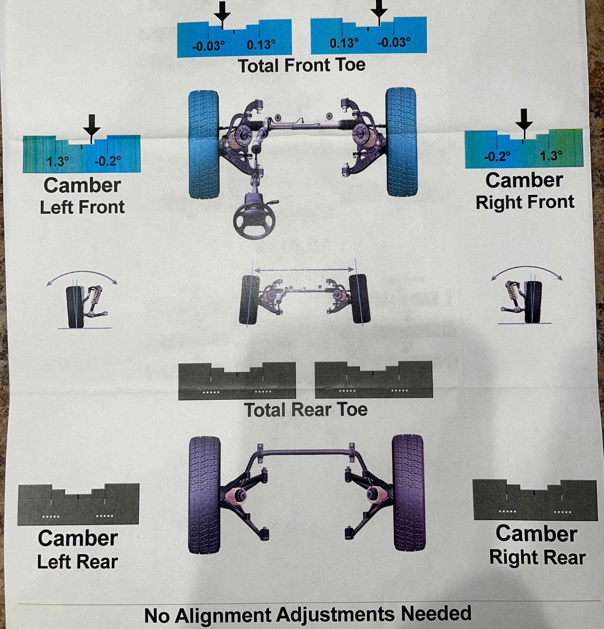

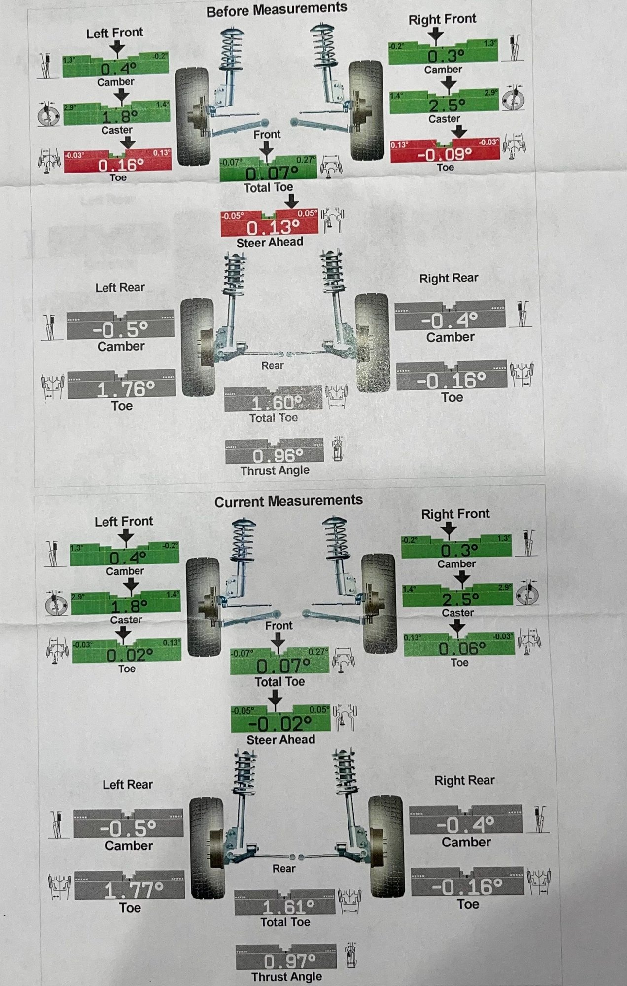

I’ll share photos of the alignment report, and the report that the tire shop gave me in my paperwork when buying the first set of tires from them. It does show the same rear toe issue and they didn’t catch it/didn’t say anything. The second set of tires looking at the report it looks like they didn’t even hook up the rear tires, so nothing is shown for them, shared that report also.
