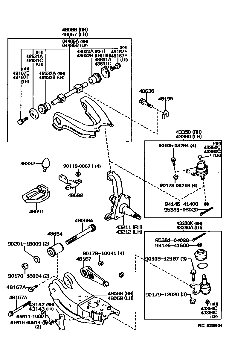

Im still pretty noob with this stuff but i was having an issue with my manual locking hubs. I toom em off, cleaned em and all that. I also had to tighten the 2nd axle or spindle nut cuz my wheel had some play up and down. Gonna replace bearings very soon btw. Anyhow, what the heck is the part called that the spindle nut/axle nut threads on to? Is it a spindle? I know its not the cv axle. It encases the axle. The problem is the threads on the spindle??? Its cross threaded and chipped very badly like someone smacked it with a freaking hammer. Needless to say i cant torque it down right and i know this is bad news but cant find that part or ANY info on it. I get most of my parts on rock auto. Anyway, any help is appreciated, thx yota tech.

Consult your manual the first page is a diagram, FSM FA-45 to FA-48. Try to stick to one thread per repair or you just make it harder for people trying to help you, and impossible for people with similar issues to find all the information.
The drive shaft, slips thru the steering knuckle

THANK YOU 85trd4runner. I thought so. I have a 1986 toyota pickup 22r. It DOES indeed have ifs. Control arms and manual locking hubs. I went to tighten the spindle/axle nut like i said, because there was some play in the wheel and noticed when i took the first nut off, the threads on the spindle were cross threaded AND it was chipped badly. Because of this, i cannot get the nut on properly and torque it correctly. I cannot find the part on rock auto, i checked for the steering knuckle but it doesn't look like the correct part. There has to be a place where i can get a new "spindle" with new threads, this seems really weird.

The 4wd has
base part number
43211(rh) or 43212(LH)
43211 KNUCKLE, STEERING, RH
43201-35020
43212 KNUCKLE, STEERING, LH
43202-35010
The 2wd has the same base numbers
It's still called "steering knuckle". Wether there is a hollow or solid spindle on it..
