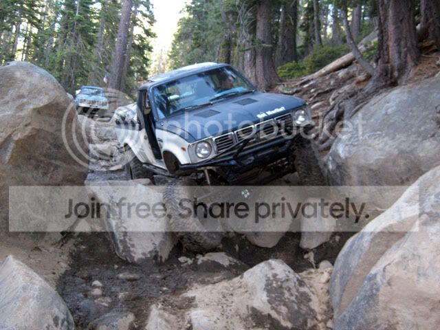

definitely get the gussets and plates as suggested by Scuba. One this to consider is the Kick out towards the rear, it has kept me from doing damage on a couple of occasions:

Adam makes a great product, well tested:
you can just see the slider
a little paint after that episode and they were good as new:

Ideally the reason for sliders is to protect your cab when you roll on a high centered obstacle.
...And you want them strong enough to support your vehicles weight.

tried4x2signN brought up some great points. Installation is easy to do on Toyota frames and you want them to be strong enough to support your vehicle's weight.
Most suppliers nowadays supply triangle gusseting which spreads the load greatly increasing the effective contact area at the frame rails. You'll want to install at least 2 gussets per leg in a V-configuration, like this:
O
...to add extra support to combat upward bending moment forces. If possible, I'd add a 3rd gusset positioned downwards at 6 o'clock.
I am running Marlin Crawler sliders and I can pick the entire side of my truck up from any position along the slider while still being able to open/close my doors (slider does not yield into the body). I have dropped off a ledge so hard onto my slider I got a mild whiplash! Thank goodness they are there!!
I've been using the same Marlin Crawler sliders since 2004 and my cab owes it's life to them! Seriously. I cannot Rock Crawl without them!
Dropping into off camper holes becomes less worrisome...
Works great in tandem with flat belly setups...
