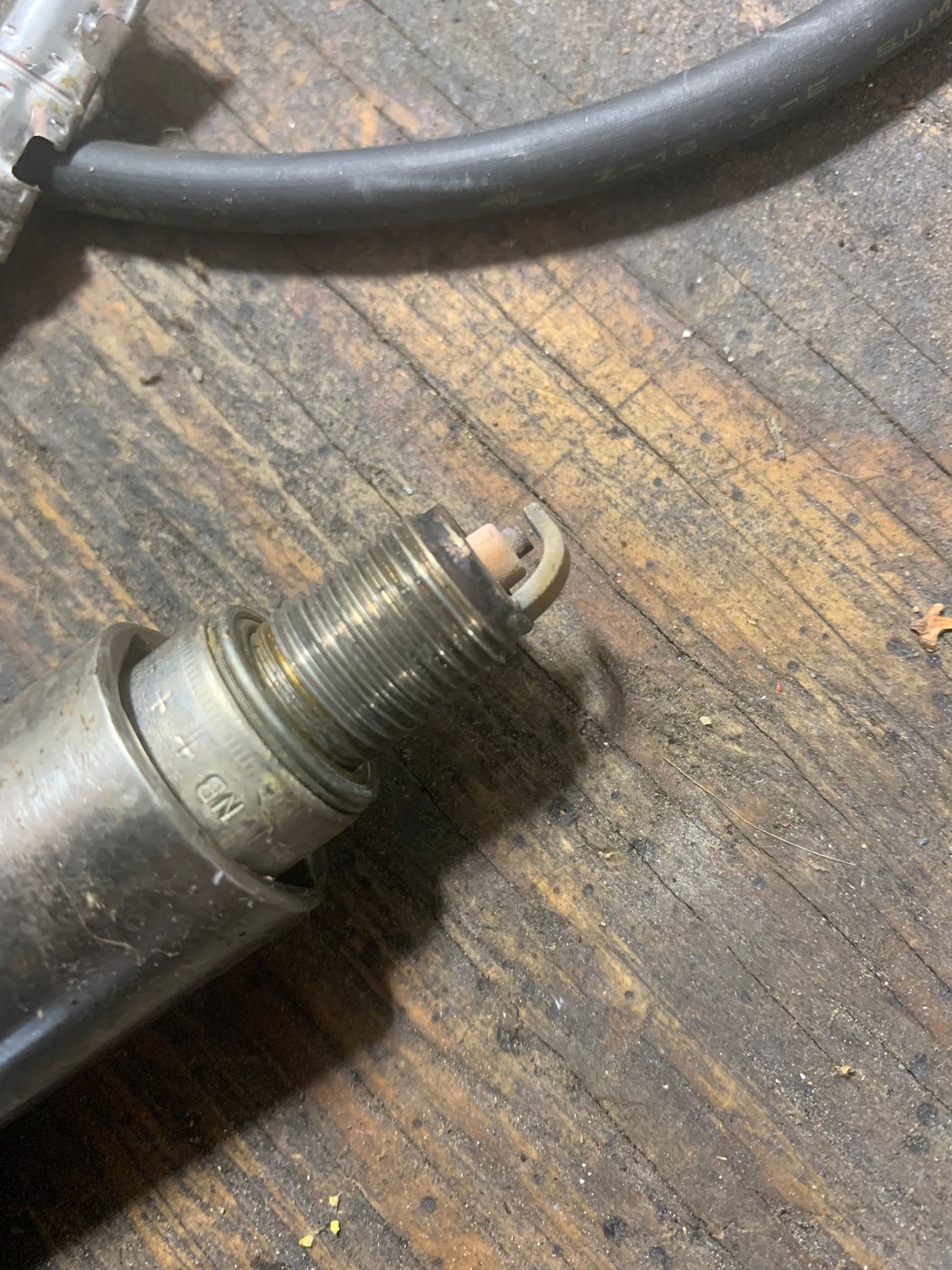

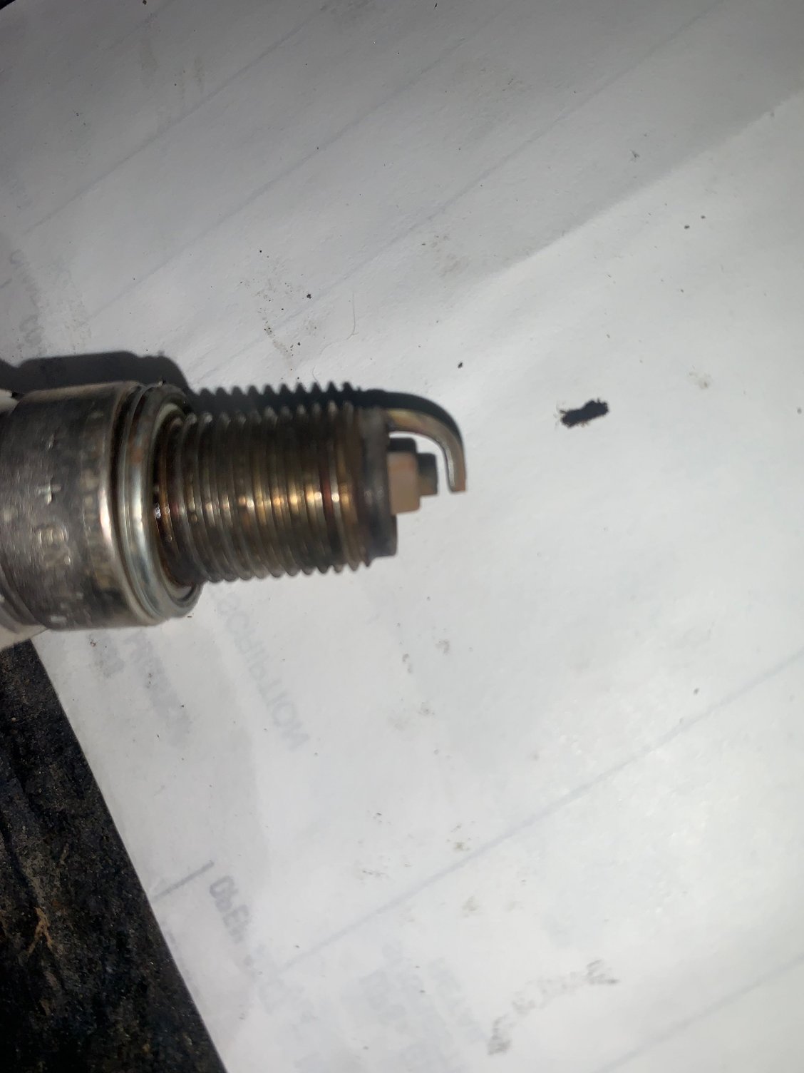

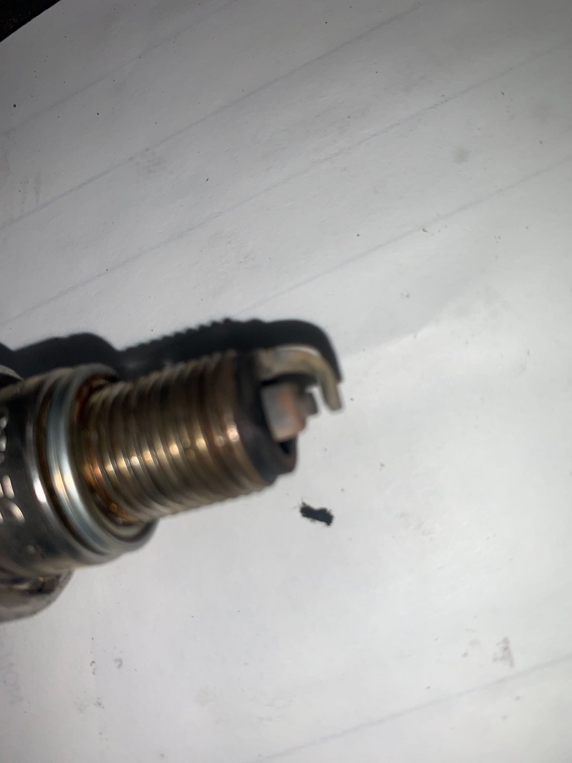

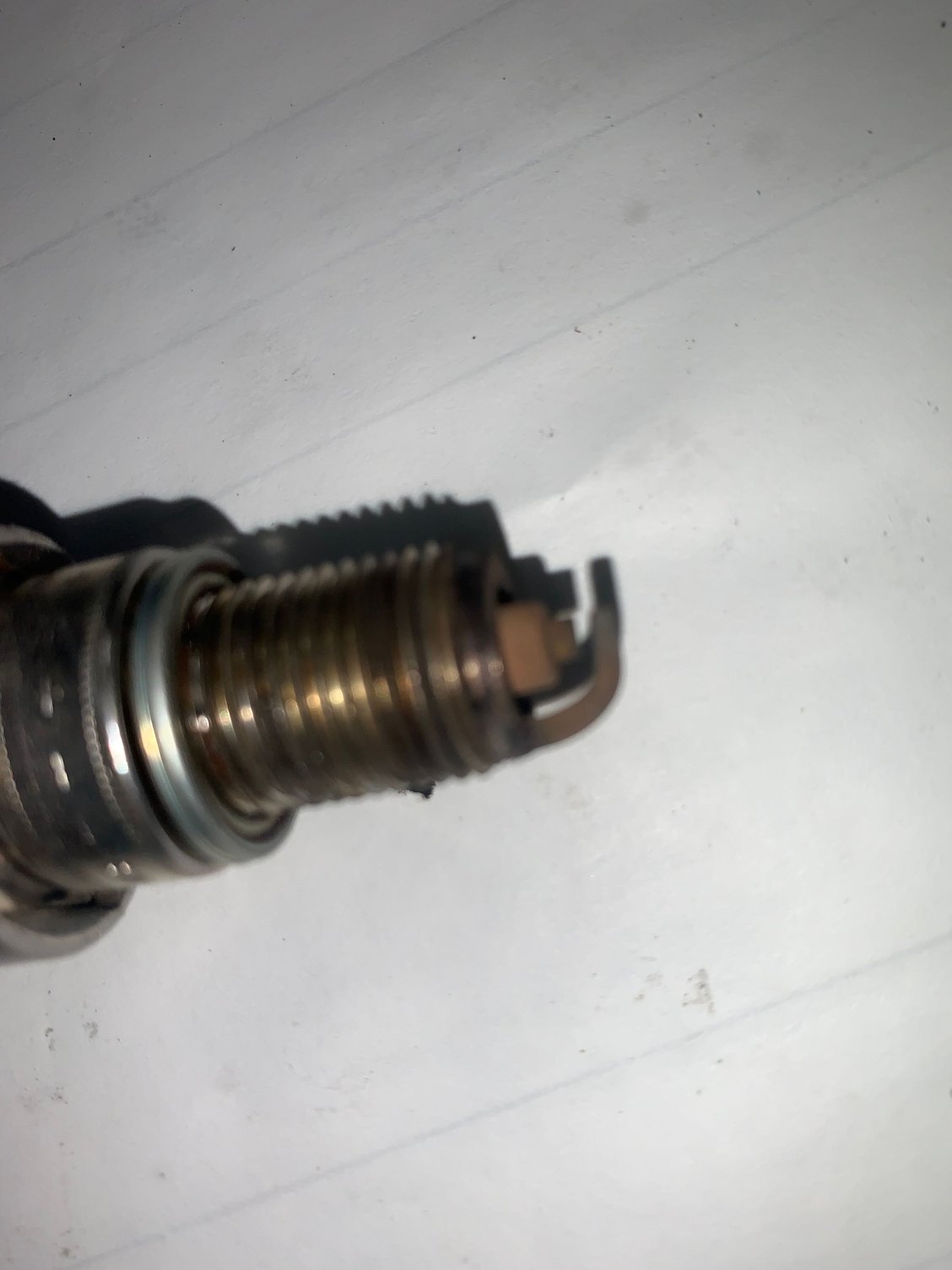

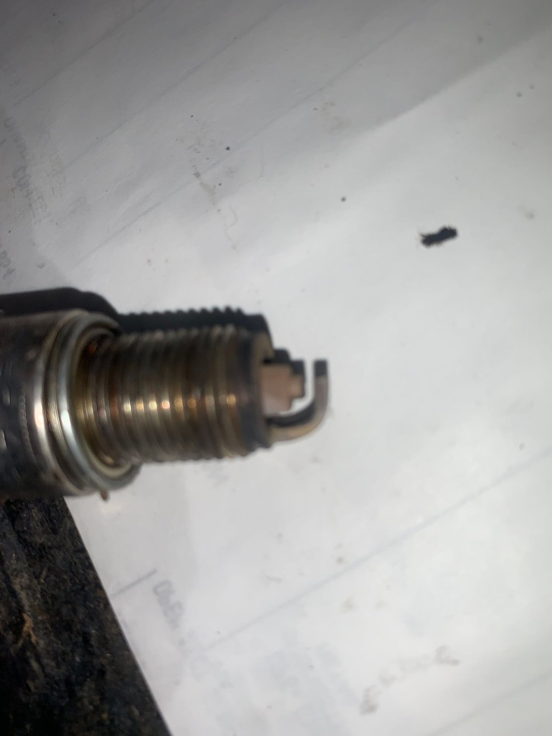

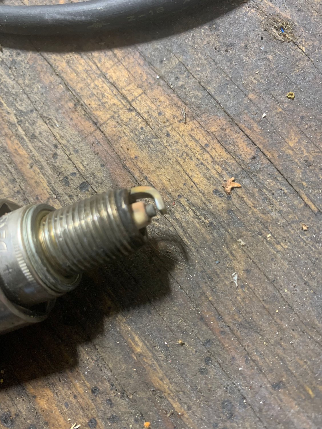

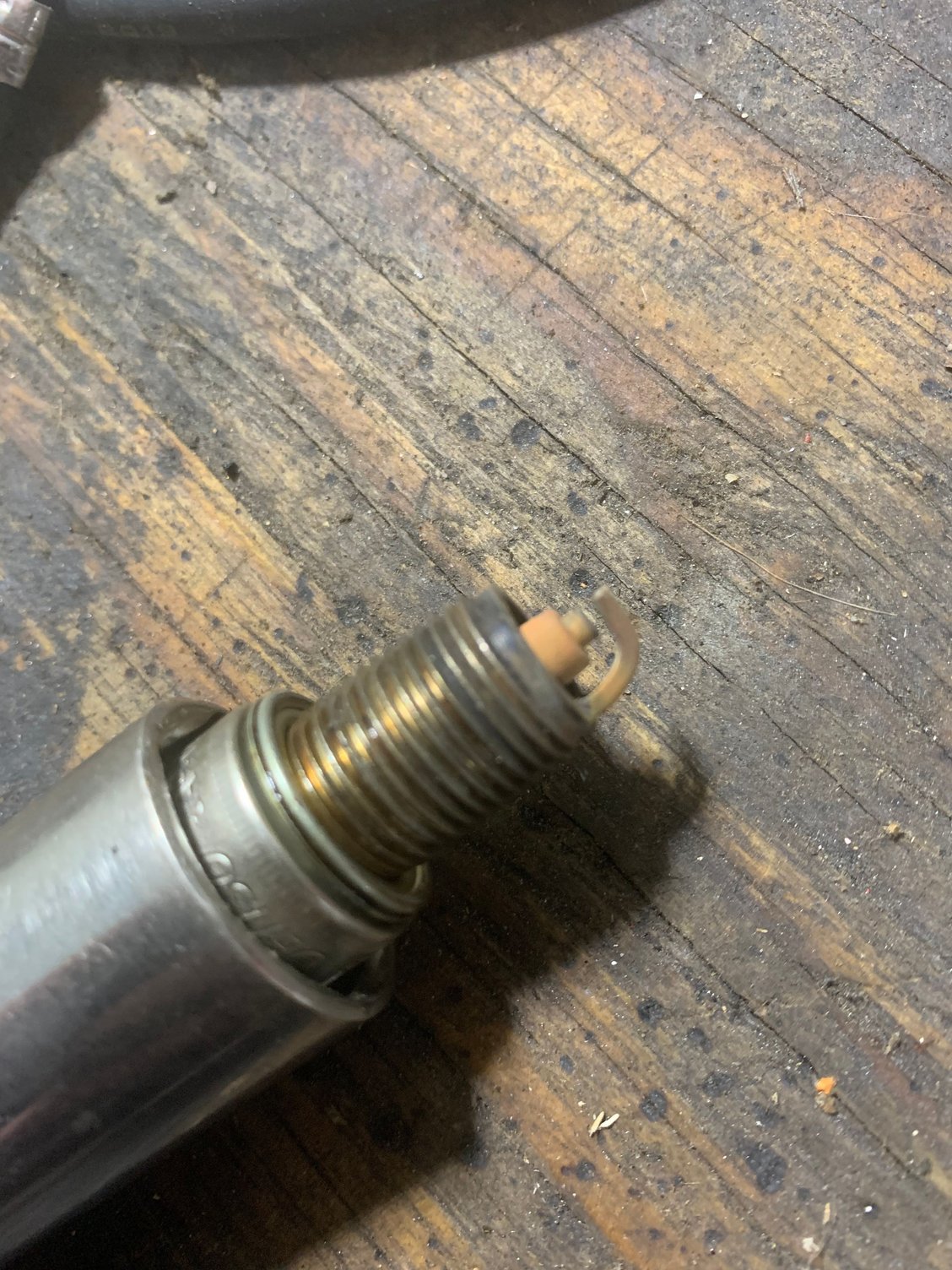

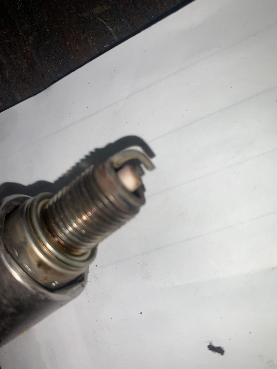

Pics of plugs
Well now I’m starting to rethink everything dang it. My plugs (at least to me) look beautiful and tan colored.
what on earth could cause such gutless power, slight stumble at idle and long crank times when its either hot outside or once the engine is warmed up.
I’ve included 2 pictures of each plug, in order from cyl 1-4. Pics of both sides of each plug

Excessive exhaust heat makes me think Plugged catalytic converter… Just unbolt it and see what you get.

It was brand new from LCE, a high flow cat. Replaced it when I rebuilt the engine along with their header and full exaust.
Started smelling the burnt gun powder smell soon as I put it to use too.
i may be over reading the way the air injection pipe looks, I did paint it with high temp paint, but it wasn’t never painted stock, sort of looked anodized or something stock. Maybe that paint I used is just not made to hold up to the temps of the air injection.
but something weird is going on. And it had me absolutely stumped at this point.
