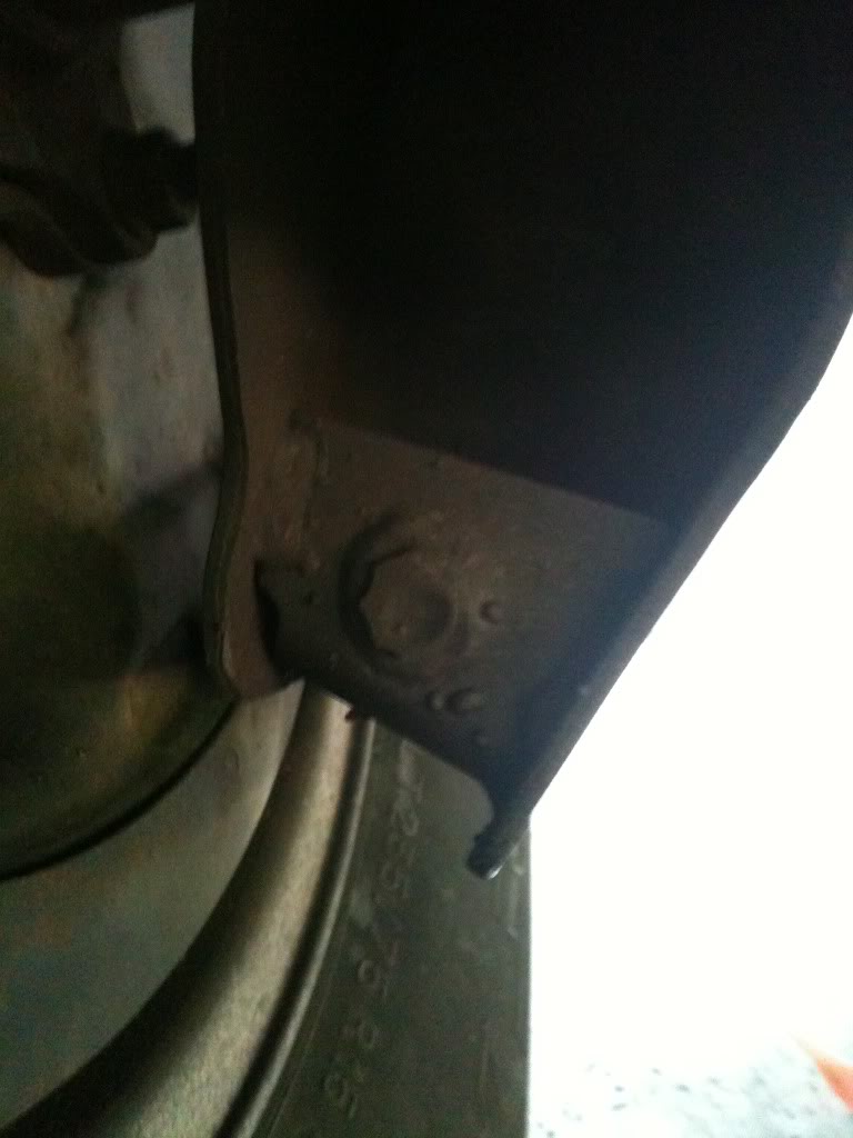

So another speed bump...
That's the other side of the nut/bolt holding the bottom of the shock in place. I think I know why it wouldn't budge now...

Mine looks just like that. That is not the back side of the bolt. The bolt is a stud, but doesn't protrude out the other side. You just aren't trying hard enuf

Looks like I don't have any excuses then lol.
No matter how hard I try I cannot get it off. Oh well, looks like Im stuck with waiting for a local auto shop.
