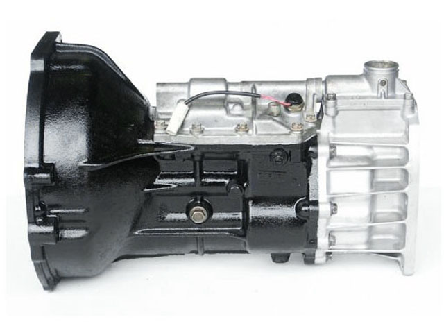

I just got a good deal on what appears to be an L52 (Top Shift) unit with the short case behind the bell housing. I'm trying to get my 84 4Runner back on the road and have the original G52 unit with the tall case. I have been having 1st/2nd gear shifting issues sine November and making it almost impossible to drive. Does anyone know if it's possible to trade out my long case with the short case currently attached to the bell housing of the new transmission?

On the terminology that I think I may be wrong on. I'm attaching a couple of pictures (hopefully they come through) to help explain what I was trying to say. When you look at the pictures, the L52 has the black bell housing and the shorter rear housing versus the G52 with the longer rear housing. I was trying to see if it's possible to swap out those two parts

Absolutely not possible.
