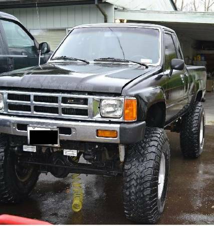

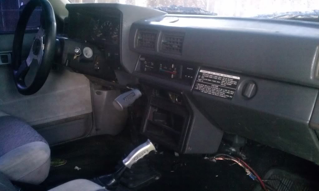

heres a couple pics. first one is the day i got her (sunday).. second pic is from tuesday..

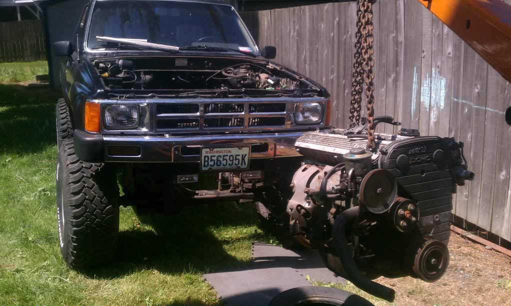

alright, well i found a motor and radiator today!! whoo hoo. engine has a miss, but i think its due to moisture in the distrubter. will know more tomorrow. previous owner said bottom end was rebuilt 20,000 miles ago. oil pan is still nice and dry, so that leads me too believe what he says is ture. also has a rebuilt head and brand new clutch as well. im gonna clean it up a bit as well as the engine bay before i install it.

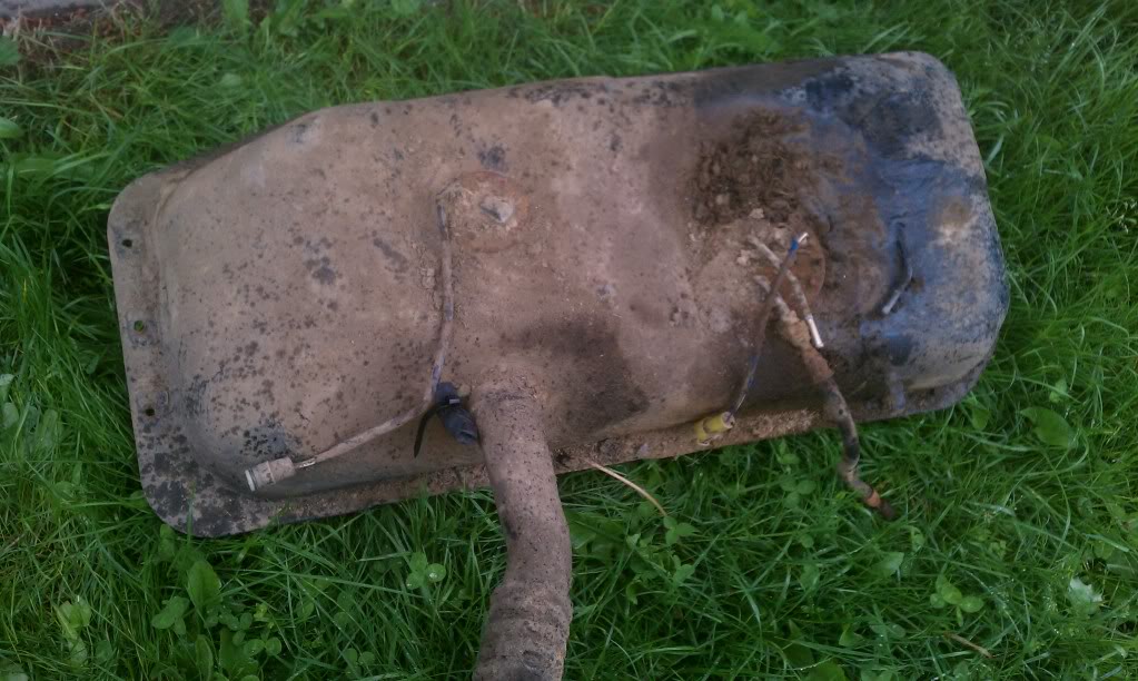

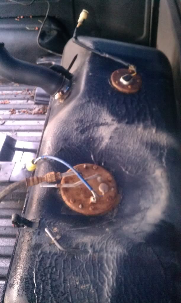

now its off to the exterior... two of the three gas lines were re-routed for the 6m swap by previous owner. bent beyond saving, i located the two lines that run along the bottom of the cab off craigslist, but im still in need of the bigger line that runs along the frame and attaches to the fuel filter. i also pulled the gas tank and cleaned it inside and out... one more gas line to locate and i can reinstall the tank. heres a pic...

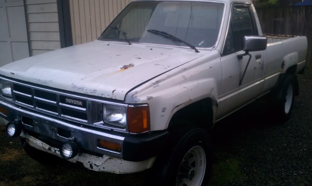

well, i called the guy i got the motor from to see if his 87 long bed fuel line was still available. he said he was tired of the mass phone calls and flakes from craigslist, so he made me an offer i couldnt pass up on the entire rest of the truck. besides the items i bought, the only other items he sold was the seats! So it looks like i get to ditch the carrier bearing driveline for the 87 one piece!! Also get to acquire the steering gearbox for a future hi-steer project. I think the rear axle is wider then the 85 axle but not for sure.. maybe somebody else knows what else i should grab off this truck before i sell it off.... what the hell.. heres a pic...lol

Rear diff should be 3" wider. I would get trans and case at least for spares.
