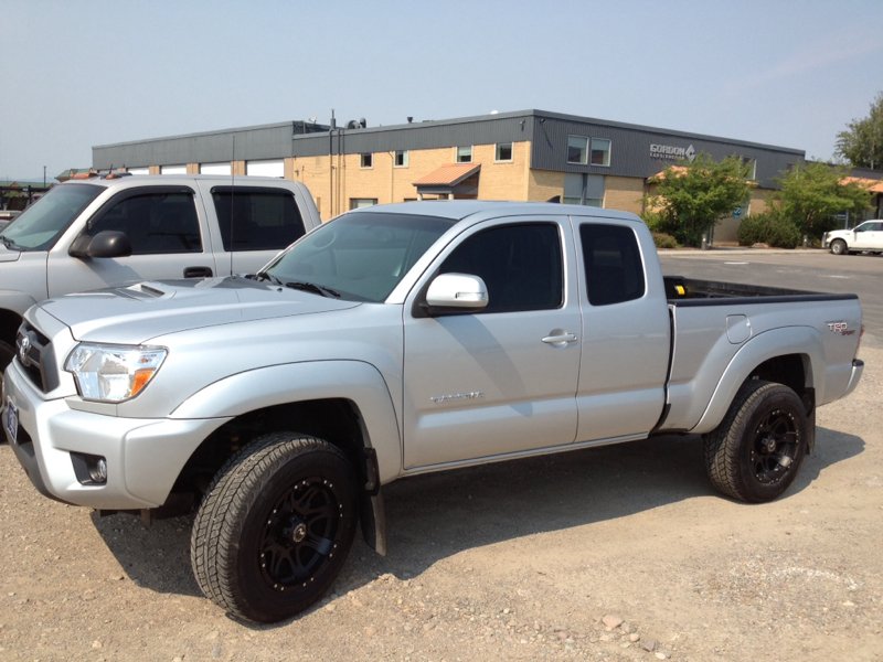

Originally Posted by HARLEYORANGE
Thanks for the reply, they do not make near as many options for the 5 lug. If that works the same on mine that will be great.
Leveled rimed and tinted
