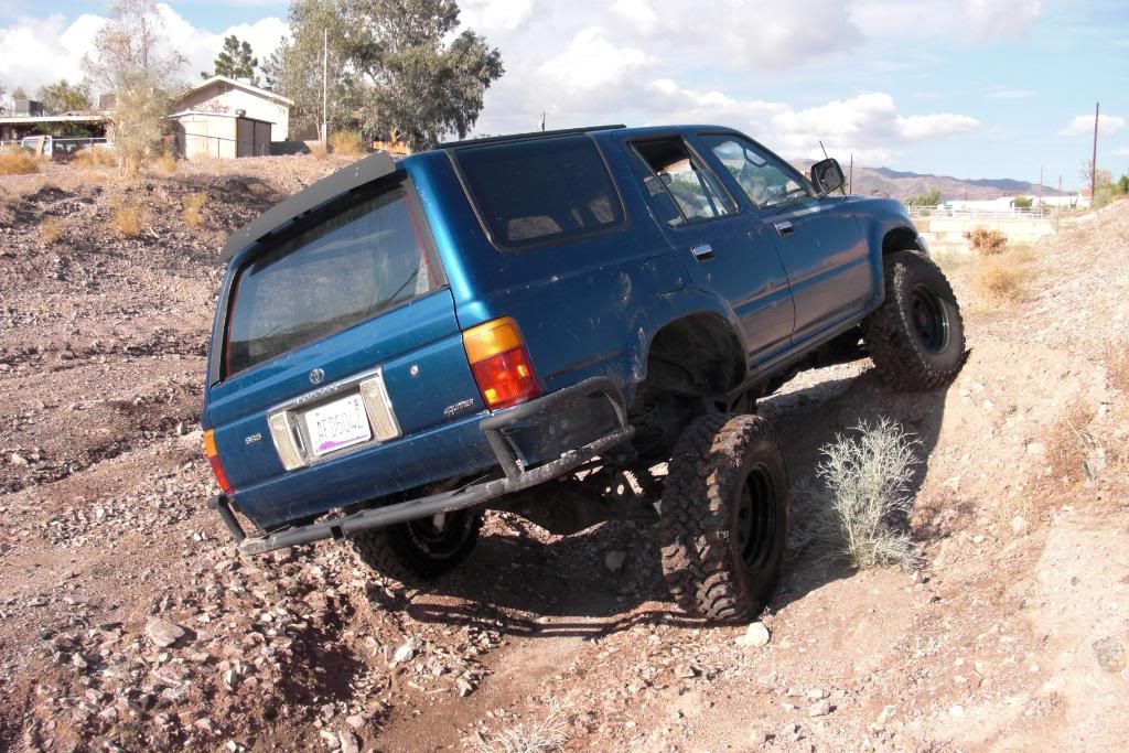

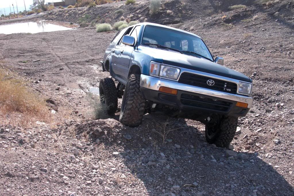

thanks BigBluePile...
some people may not like this set up...because its more for show...but i like to take things like this and make um work just as good as others do...(be a prolbem solver...)
the prolbem is that theres not enough spring load on the tire that droops...well come up with a sloution that will fix that...come on guys you guys can do anything...

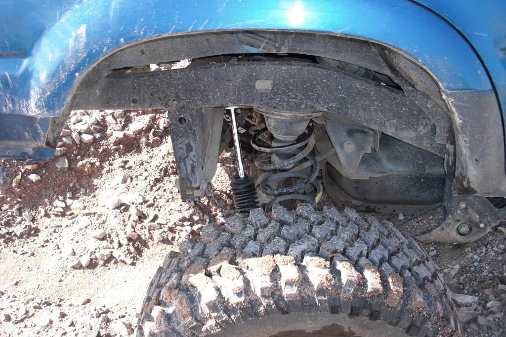

Dirty hooker flex:
Loose spring, shock boot unhooked, it's a mess:
I've even got the upper control arm contacting the gas tank:

What length shocks are those?
For a ~4" lift. Probably an inch or two longer than I need, but they work great and for the price I couldn't pass them up.

You know bottoming out a shock is BAD, right?
My guess is the compressed length is about, oh, 4" too long ...
:SIGH:
It's actually only about 2" longer compressed than stock and still tucks my tire far into the wheel well. It's not written in stone that you have to run a "4in shock" with a "4in suspension lift" plus they do make extended bump stops ya know?
I'm planning on getting OME springs real soon so it would be dumb to buy "stock lift" shocks.

So long as the shocks don't bottom out, more power to ya!
