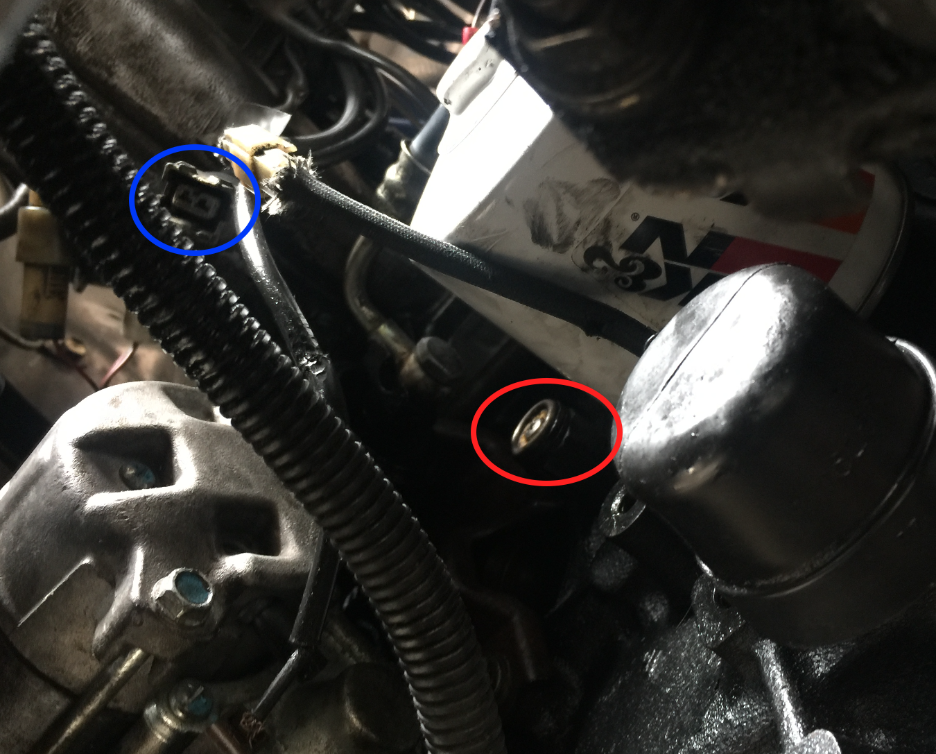

gixxsta04 you're digging up some pretty old threads to stack your post count.
To the OP looks like your knock sensor is broken, hopefully you found a fix for all of this, we'd love to hear what it was.
