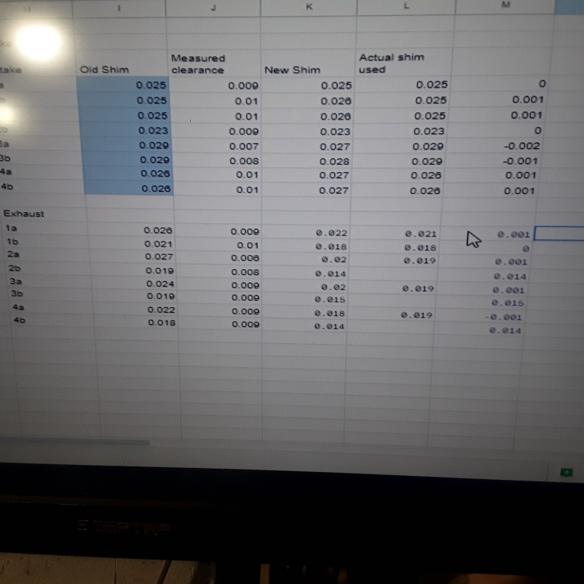

timing was off when I checked compression so spent yesterday rectifying that. Swapped a couple shims to get a more even spread of valve clearances but I haven't dbl checked just yet.
that's next up today.

timing was off.
so decided to reset the valves while the cams were out.
Set up a spreadsheet to track it all.
first with what came in the 5s head
Second using a few out of the 3s
SS of final numbers for valve clearances
third time rearranged that batch and got it down to spec minus 3 I spent an hour identifying pt # to thickness. 🤞🤞
