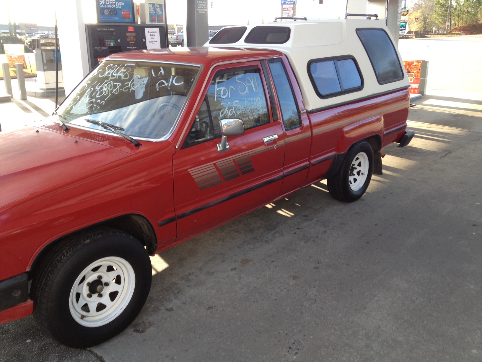

How about to start off you post pics of this sweet 85!!!!!!! And only then will you get your troubleshooting tips, it's in the new member rules that if you have an 85 pics first then questions later.
Not really but we love pics here, welcome.

Here you go
Ignore the price on the windshield not what I got it for. I bought it in Georgia and drove it to texas
