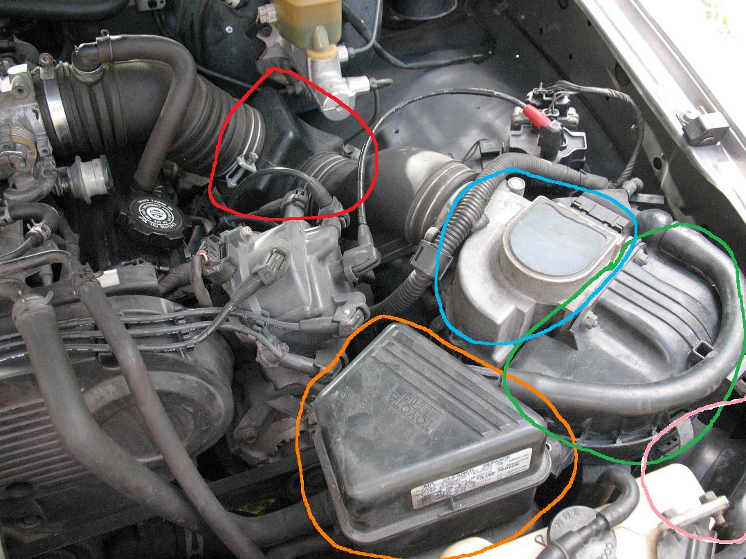

I found a thread just like this for other motors, but not one for my 3.0 V6. I read up on the ISR Mod but still am not sure exactly what I am supposed to be removing. Can somebody please identify the following circled parts for me?

You're going to be removing everything there except the VAFM (the one in the blue circle). The truck won't run without it. All the other things are silencers and the airbox.

Anybody want to start with what the thing is circled in orange?
I got into an accident and upon receiving my truck back from the body shop, that piece was not screwed back in (the 2 bolts that hold it in are missing). I tried to move it around and figure out what it is, but it didn't seem to open up or anything...

The circled Orange box is the AS valve resonator box.
The AS valve opens during deceleration and allows air to flow into the exhaust and does 2 things, first it keeps exhaust velocity for longer scavange affect, Second it lets O2 in to help the Cat burn cleaner.
You can eliminate it and run the hose directly to airfilter housing, Some just put a small airfilter on right out of the hardline but its noisy.
The red circle is the SRS along with the box under the orange circled box.
The hose that connects to the box under the orange box goes to the AC and power steering idle up, just repipe that to a place before the throttle body and it will work fine.
The blue circle is the Air Flow Meter, Cant get rid of it and don't mess with it.
You basically mean anywhere into the intake pipe, right?
And what is the pink circle all the way towards the bottom? It looks like the end of a megaphone or a horn, and appears to go straight into the back of the headlight...

That is the air intake, Its piped to pull air from behind the headlight because it is cooler them drawing air from inside a hot engine compartment.

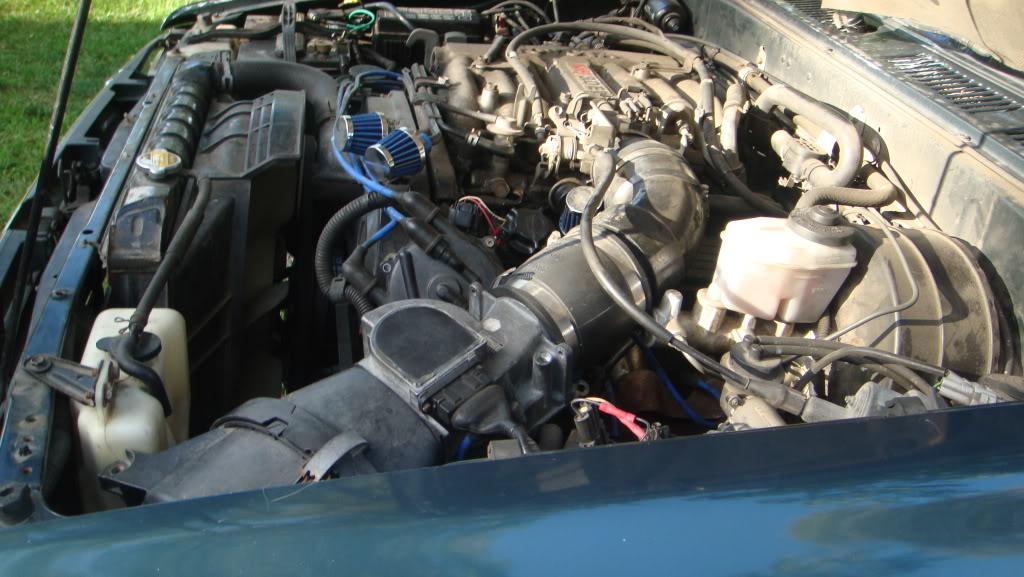

When I did mine, I left the stock air box (with filter in it) but had already removed the elbow that pulls air in from the fender (the pink circle in your original post).
All you're really doing is removing the two large 3" diameter rubber hoses that run between the VAFM (circled in blue) and the throttle body, as well as the triangular, plastic box that connects them (under the brake master cylinder).
From there, there is a hose that "should" be plumbed between the valve cover gasket to a fitting on the ISR tube (an always open crankcase vent), and one that goes from the hard line closest to the distributor (there are 3 side by side at the front of the engine) to another fitting in the ISR tube.
Lastly, there's a long, thin box that is sandwiched in the air box mounts that connects to one of the large 3" hoses, that can go too.
Here's a couple shots of mine before the 3.4 swap:
This is how your airbox should look when re-installing it:
It may not be obvious now, but when you get in there you'll see what I'm talking about.

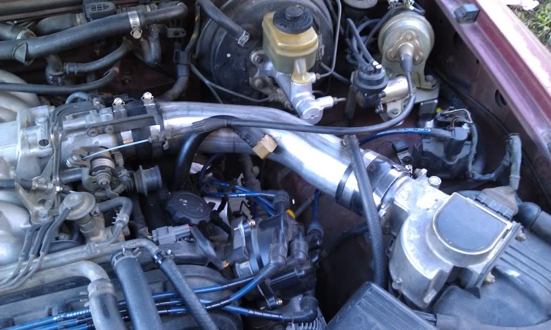

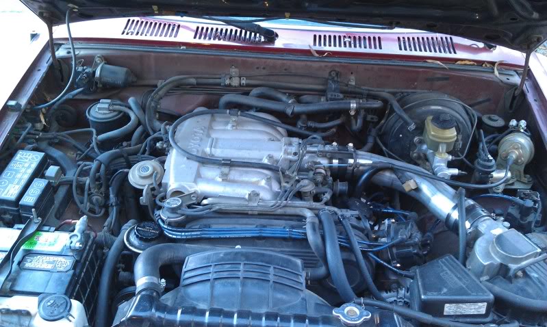

here are 2 versions of an ISR that I had/have on my truck..
current version:
of course my egr/pair delete affects how much of the intake pipe and air boxes I can remove

bone collector I do not have the option to quote you, but your second pic is what I wanted to do - basically just eliminate the intake silencer itself (which is circled in red in my OP) and nothing else.
This should yield the same results as doing anything else, right? Since the "mod" specifically refers to removing the intake silencer because it is the restrictive part? Removing other items is just a "bonus" to clean up the engine bay or whatever, correct?
