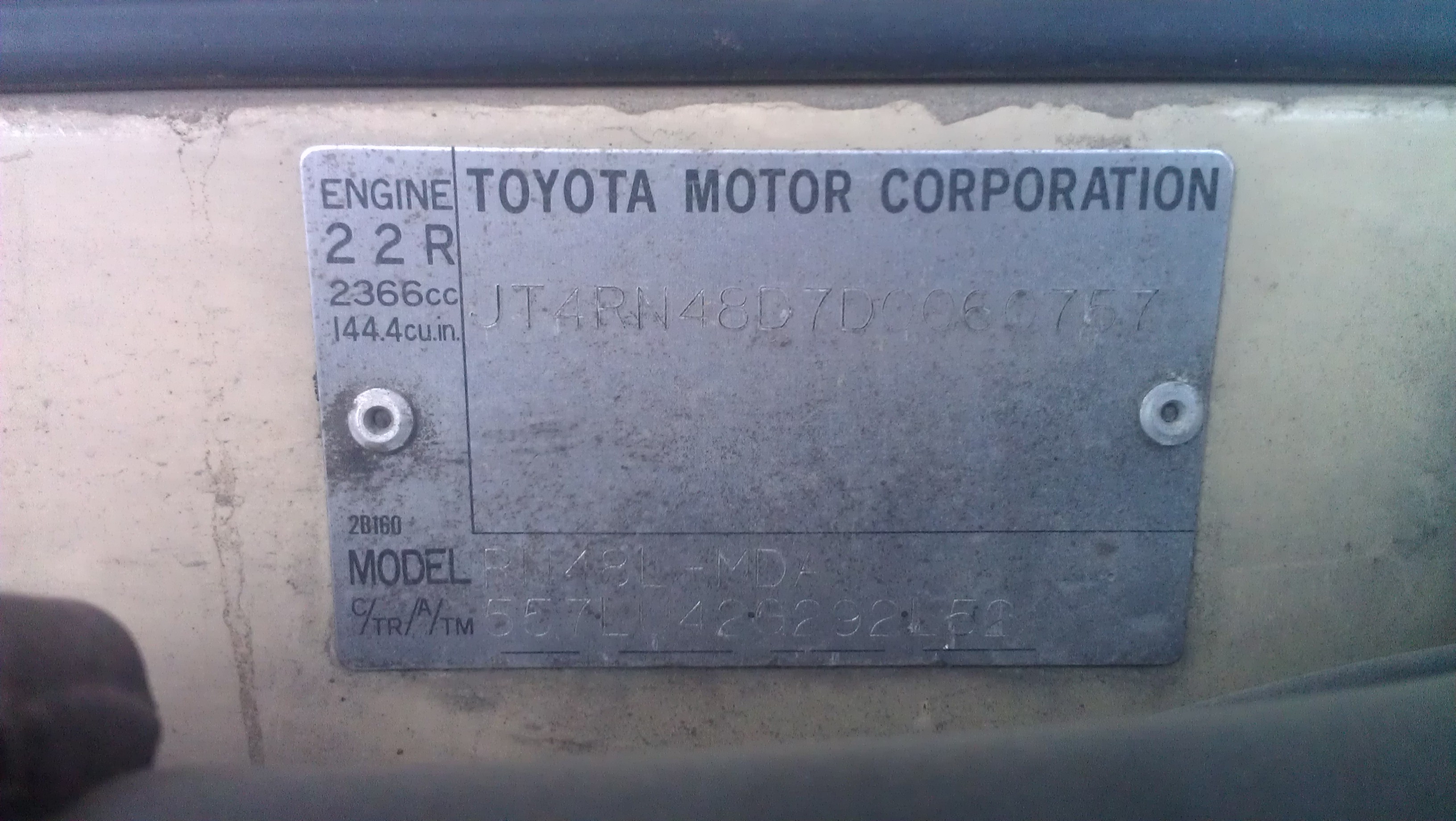

Exclamation heres a picture of the plate in the engine bay
i keep using attachments but i dont think that will last very long i need to figure out how to get the url of my photos.

I think I see G292 & G52.
So you have 4.10 gears according to that tag. 2 pinion, 4.10. The G indicates 8.0" diff. The 29 indicates 4.10 ratio. The 2 indicates 2pinion. The last few digits is G52, which is the model transmission you have.
Thanks man I greatly appreciate it .
