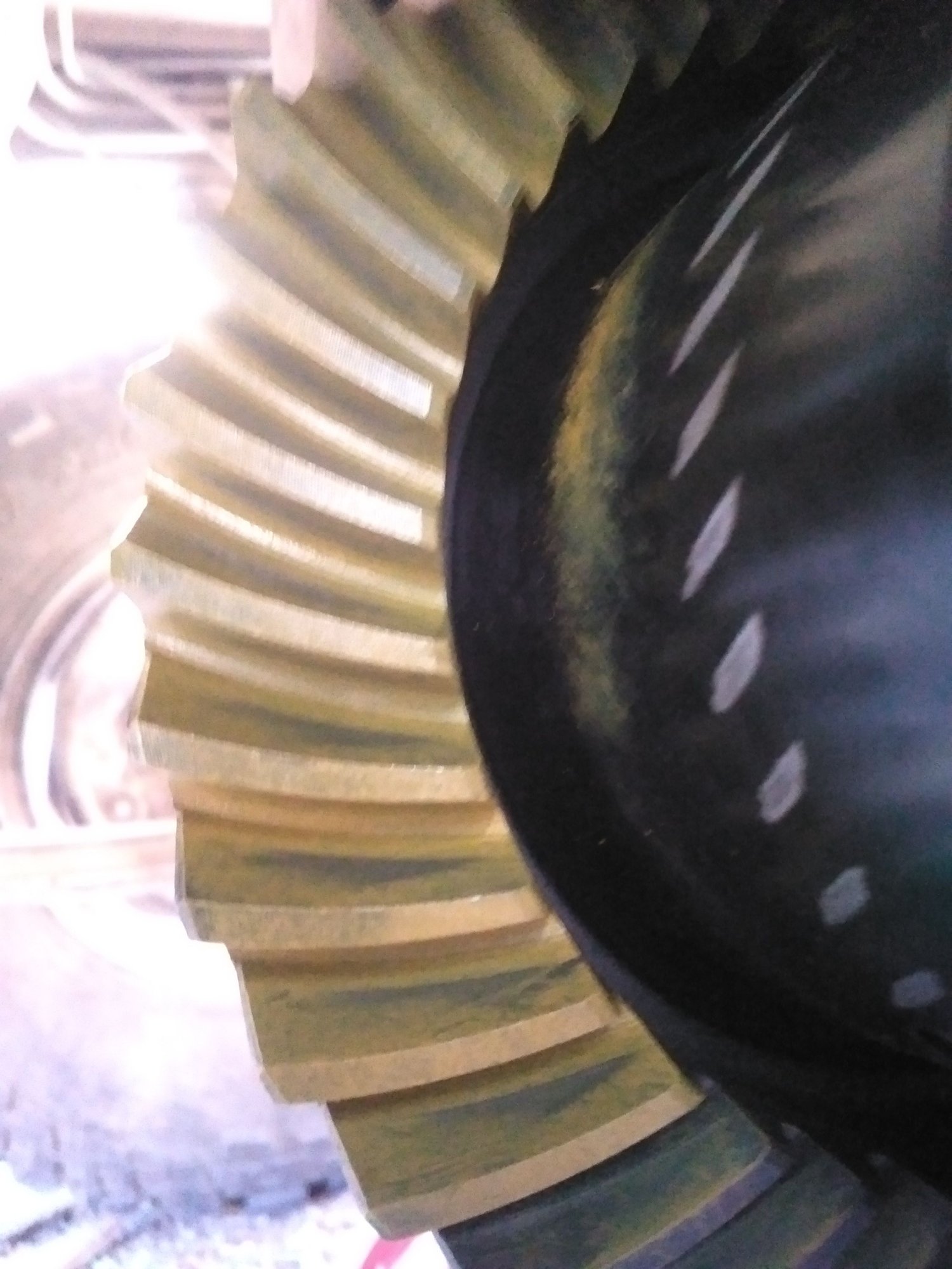

Contact pattern help please
My 1st time can I get help please reading pattern

What is the backlash set at?

Backlash is .06 and pinion shim 20

Backlash .06 pinion shim 20

Looks good to me, but Im no pro.
Maybe @ZUK could chime in. Hes the best in the business.

Quick public service note, as rattlewagon suggests, you can go to www.gearinstalls.com, ZUK has tons of info and pictures of good patterns.
Also note at the bottom of his page there is a little Paypal button where you can thank him for reading your pattern with a small payment. A few dollars to get a professional opinion on your gear pattern, shim choice, etc is an amazing deal.

Hi Dice88-
I can see from the coast pattern that your pinion depth is too deep. Try taking off .006" and post more pics. Post a clear pic of the drive side👍
ZUK

Will do tomorrow thank you for help much appreciated
