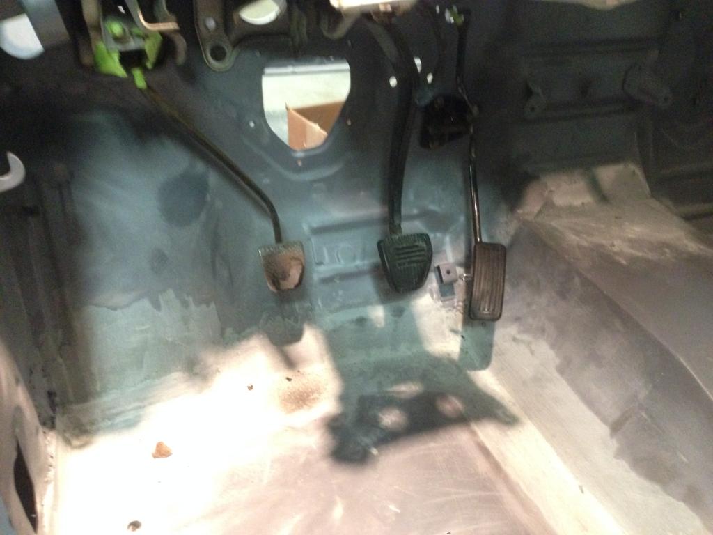

I didn't like the stock pivoting pedal on my 83 so I modified a 2000 Tacoma pedal to fit my truck. Corey (Member name: Slacker) did something very similar on his Trekker. Here's the post on how I did it in my build thread:
https://www.yotatech.com/forums/f197...l#post52208074
looks like this now:
Used to be long and narrow like this (if you can see it)
