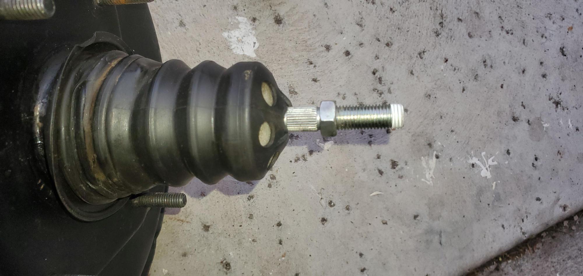

I'm 99.99 percent sure this is the problem. When I installed the brake booster the screw that holds the peddle adjustment is to long and is pushing the peddle forward I had to jam in there to get the peddle connected. The first test drive after installing all the hardware and bleeding there was a lot of air in the system half of the peddle was dead and the breaks would barely grab at the bottom, could not tell the difference in the vacuum pressure. The second time I bleed the breaks I felt the vacuum pressure after a few miles and especially on the freeway cause vacuum was being applied tot he breaks all time whit the break booster being pushed in a bit.
I had to cut off 1/8 of an inch from the end of the bolt so it would clear the break peddle completely. Marked the cut off with white threadlock.
On the reinstall I twisted the adjustment screw in until the pin would slide in freely and the break peddle would be lose and able to jiggle freely. The break booster has no pressure from the peddle right now. It took me 6 tries to install and uninstall the break booster till I got it right, tomorrow I will bleed the breaks and go for a drive around the block.
