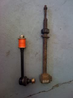

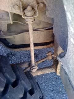

next, i need a rear drop link for the anti roll bar, i ordered on of a website who specialize in the toyota 4x4's but its too short, i also ordered a front one from them and that fit perfectly but the rear one i need is about 12" long and what they sent me was about 5", now i do know that my 4runner has been raised by 4" i think with pro comp es3000 shocks, so do i get the corect drop link off pro comp or is there somewhere else i can get one?? whats odd is the front drop link i got off that site fitted even tho the front has been raised to??? is that cuz the rear drop link is bolts onto the body and the fronts not????

and i still havent been able to find an unusually large drop link for the anti roll sus on the rear???

so i need one of these for the other side
i ordered a rear drop link and got this
Old Jun 24, 2009 | 08:11 AM
