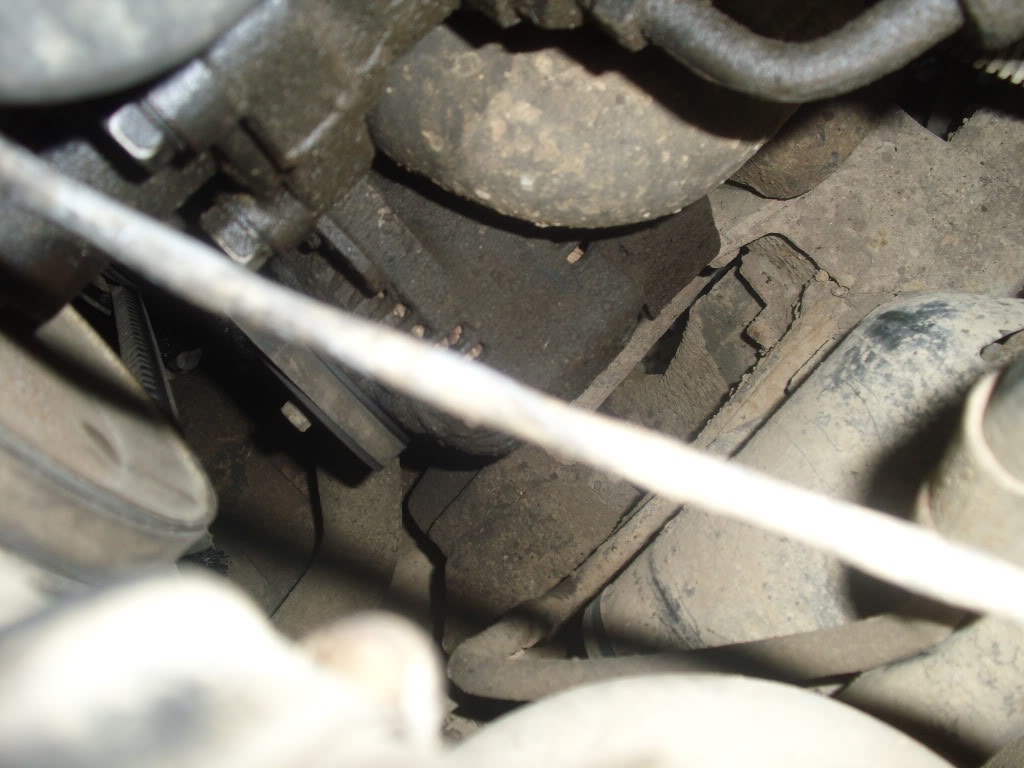

heres pics of the alternator, i havnt got around to cleanin it yet, but prolly tomorrow. im on the lookout for a new one also, and a new battery. but ill clean it and see what happens.

I would take the alternator apart to clean it. I have had good luck using this stuff. It's pricey but perfectly safe to use and works pretty dang well:
http://www.autozone.com/autozone/acc...er=119711_0_0_

Was just about to suggest lectra cleaner
Used it on my old old alt. and it cleaned the sludge off.
too bad the thing was still dead lol
