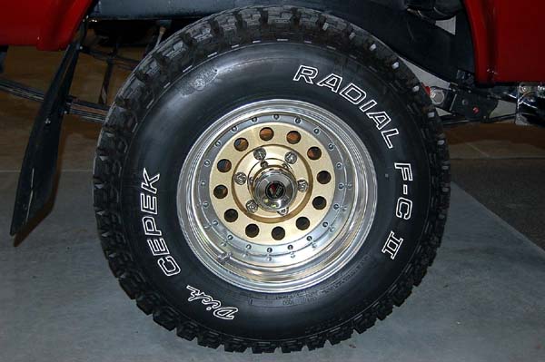

32x11.50 if the Enkies are 8 1/2"-9" wide. I have seen some 33x12.50's on 9" wide Enkies but I think that may be pushing it. I run 33x12.50 on my Enkie 10" wide wheels and 31x10.50 on my Enkie 9" wide wheels. The wheels are identical model 30 units except for width.
Attached Thumbnails Aftermarket 15" Enkie wheels: tire sizing assistince please!-untitled-1.jpg

I run the Dick Cepek Fun Country II Radials. I ran Armstrong Norsman Radials for 80,000 miles on the first set, 70,000 miles on the second set then Armstrong went out of business. The Fun Country II Radials have the same tread pattern, design, etc. They are quiet on the highway, good in sand / mud and provide a great ride. I do not know what the maximum mileage will be on my 31x10.50 x15 Fun Country II Radials yet since I only have a little over 6,000 miles on them.
