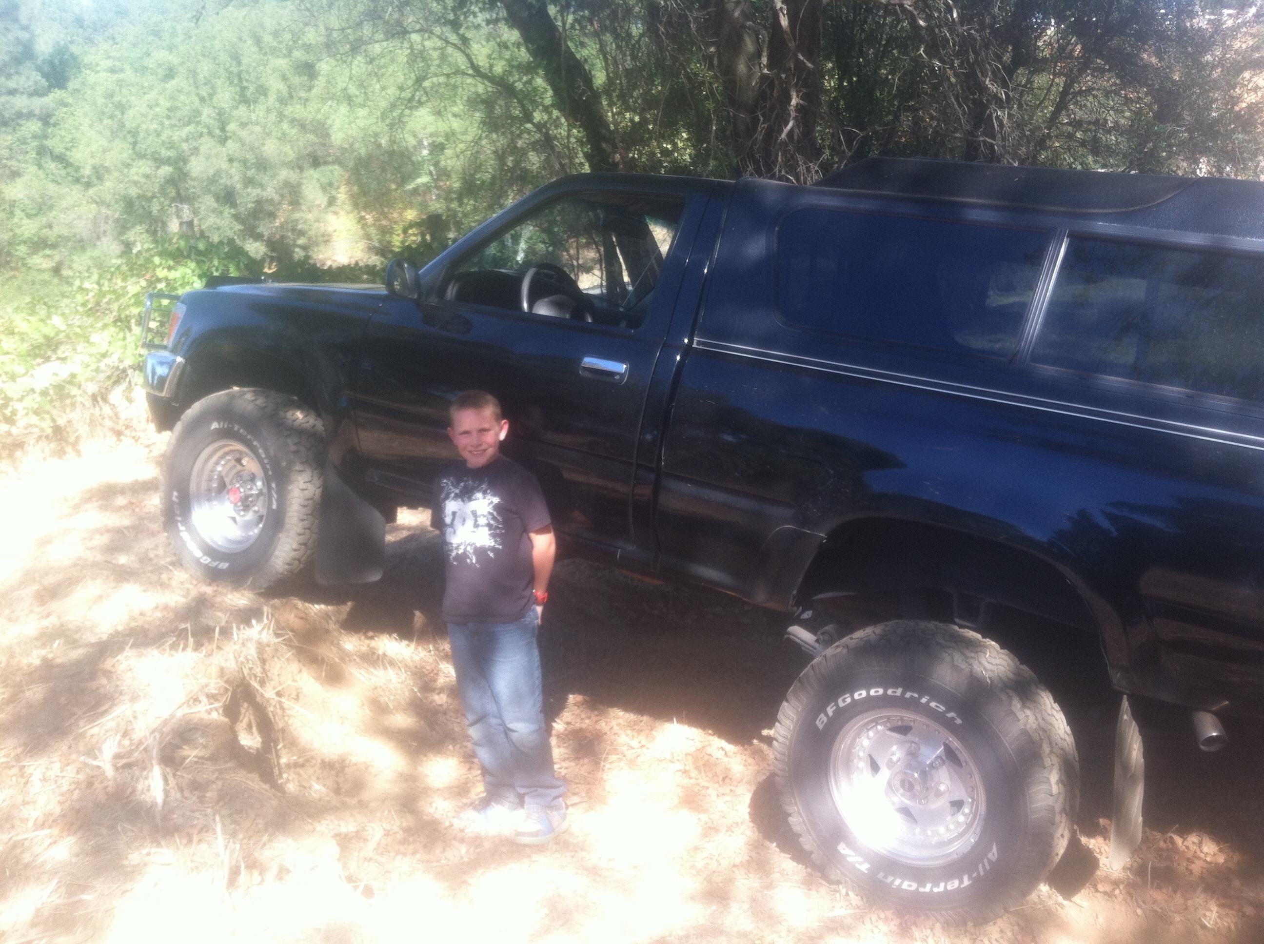

I'm new to the Toyota world. I just picked up an 89 4x4 truck with a 22re. I put some 31s and it doesn't have the same peep. So I bought some 3rd out of a 92 4runner with 4.56 gears $100. Now the runner has auto hubs and my are manual hubs. So I can use my diff cover but on the side of the housing has all the vaccum hook ups. So can delete that and take all that crap off?
