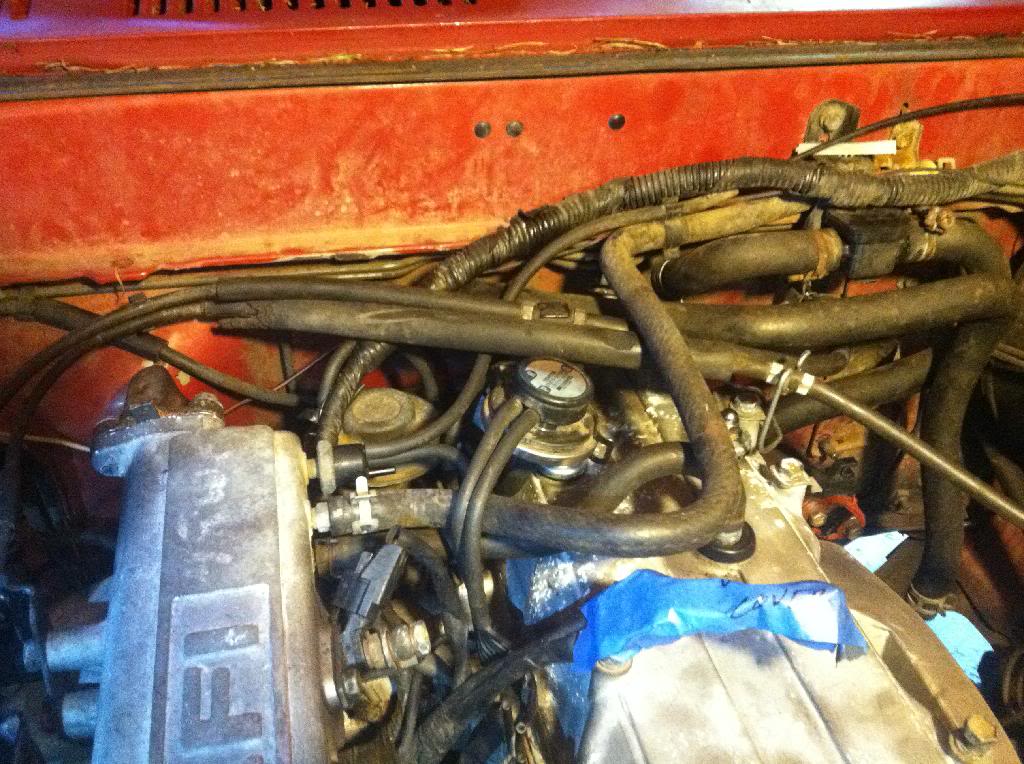

I will get a pic and post it shortly, i bypassed the egr and put in a resistor to clear the code out. after it warms up It is still idle surging from 500 to 2500 rpm until I tap the gas then it will drop to 750 and idle fine. In the morning it fires right up, jumps up to 1800 for a couple of min and drops down to 750rpm. T Thanks for your help with this.

Well looking at your picture I see a lot o open vacuums lines. Are they uncapped to show what your looking for or have they always been uncapped? If always then cap them and see how she runs. If not well I will look for helpful pictures. I will try to post some later today

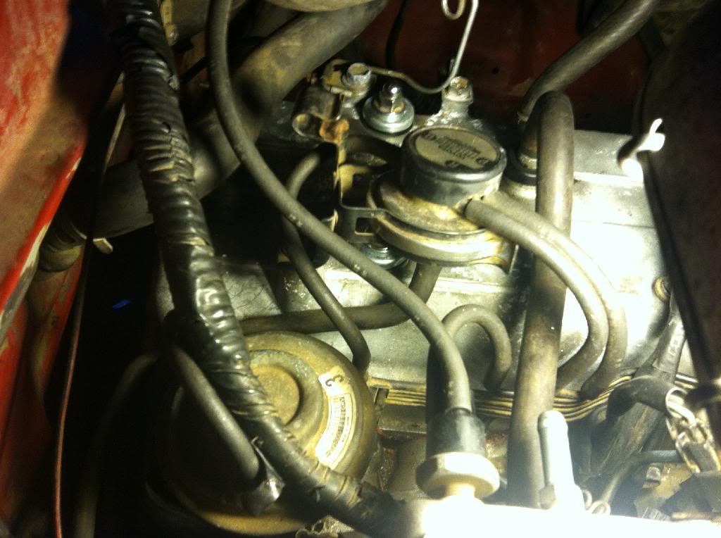

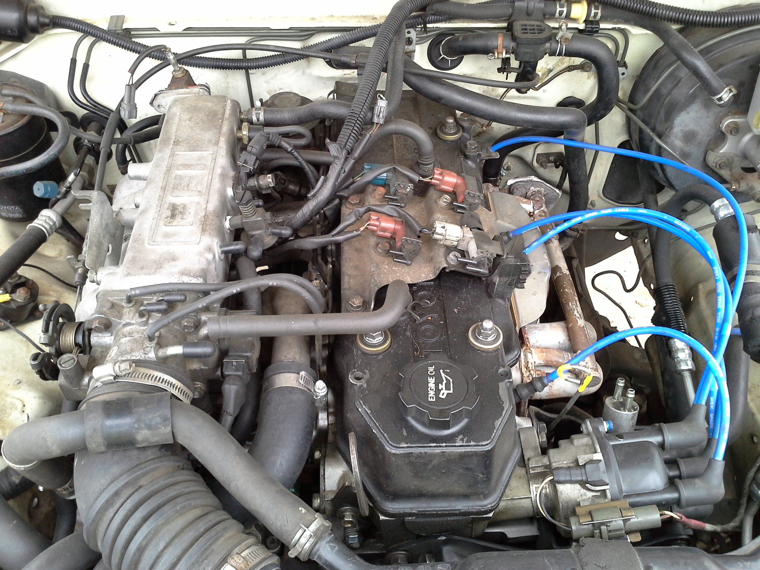

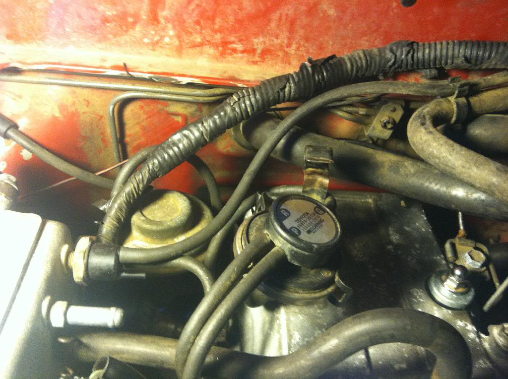

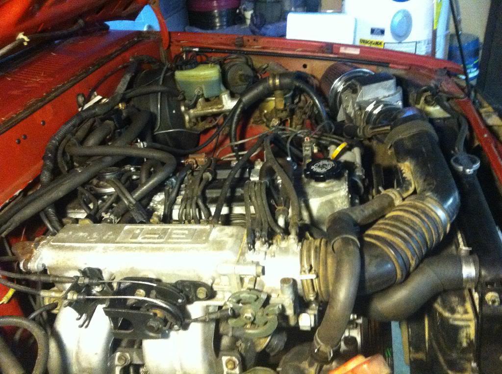

Hope these help. Most are egr related. so if you have disabled the egr then you should be able to cap the egr one and forget about them.

That should get you started. Let me know if you need more or different angles. I will see what I can come up with.
