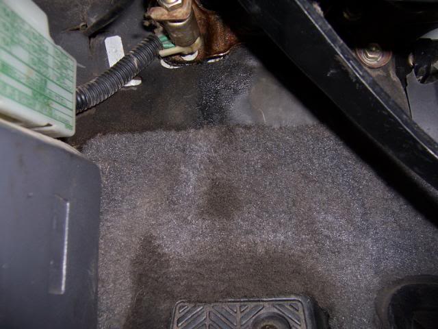

Potentially a failing master cylinder? I have the exact problem and i replaced my clutch last year. after changing my tranny fluid it got slightly better but i think its my Master as right after i did my clutch my slave went while i was bleeding the system..... and ive bled the ˟˟˟˟˟ outta my lines.
could be an internal leak within the master, happens to brake masters so i don't know why it couldn't happen to clutch masters.
if the bleeding doesn't help, maybe change the master out, since they're not super expensive if it works you wont have to drop about $800 just for a shop to look at the trans

Yup...
One thing that I forgot to mention - when it is still warming up and shifting nice, you can hear a distinct clutch noise or trans noise sounds like a subtle clicky rumble when the clutch is NOT engaged. when you engage the clutch it goes away. When it is warmed up it goes away and the shifting is hard.
Im hoping the new master and slave will solve it so Ill update after I get it in. Thanks for all your help so far!

Thanks guys, I installed a new master clutch and slave with a nice flush and my problems are gone! Well, the truck shifts, now onto the rest of the oozing, broken and whole lot of ugly you get from 317k.
