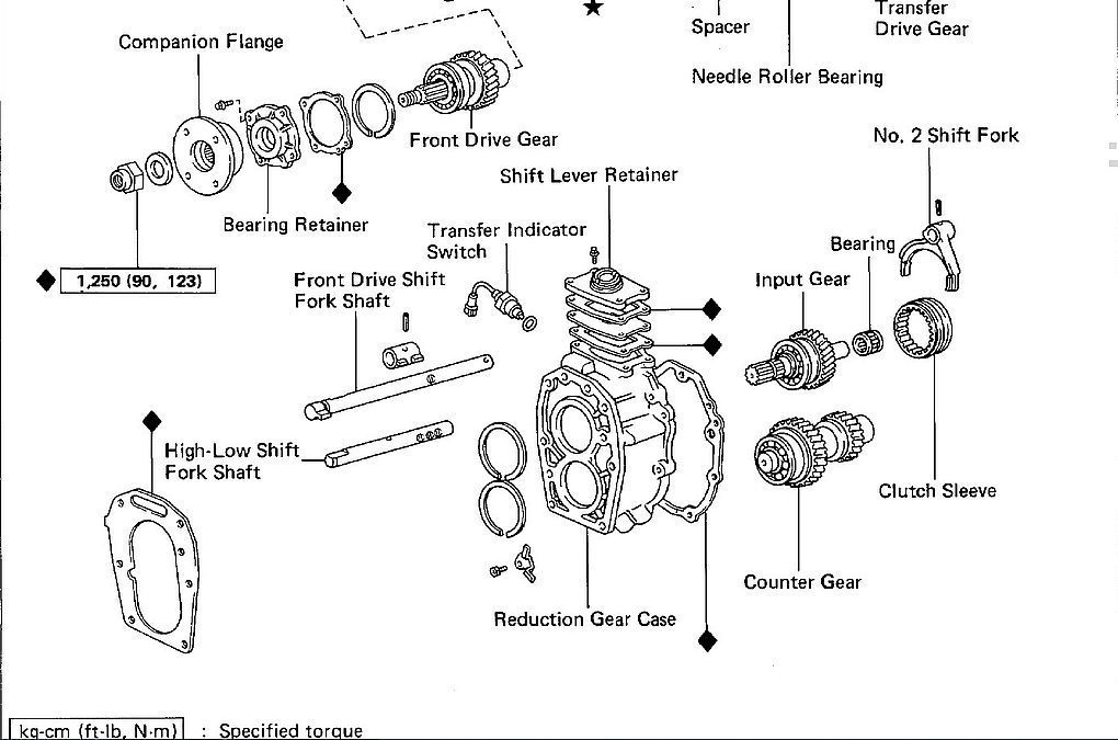

This any help?

Thanks for your reply and drawing, it wasnt stuck in 4wd, the shifter was just stuck in the wrong position, I think and I fixed that. I was wondering if there is supposed to be a hard plastic bushing down under the 4wd shifter? I don't see one on this diagram, but they definitely sell them for this year truck, does it need that bushing?

The R1A transfer case used in your 1987 'Runner 22r application does not have a shifter bushing. The shifter ball rests directly on the metal radius machined into the shift lever retainer.
There is, of course, a plastic or hard rubber bushing in your w56 transmission shifter.
I think that the chain drive cases used in 6 cylinder applications might use a plastic bushing, but that does not apply to you.
