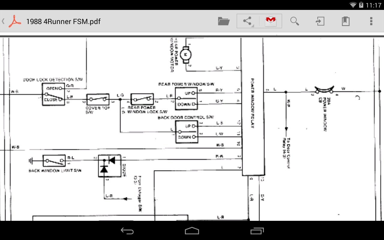

Rear window lock switch, now to figure out how to disable it. I haven't found any wiring schematics that show this switch.
I tried for many minutes to get this shot clearer. Best i could do.
Looks like you just jump it to bypass. Simple inline circuit opener

That is the one wiring diagram I couldn't find. Thanks for posting. There are 4 wires that go into the switch. 1 ground for the light, 1 power for the light, and the 2 wires for the window lock. I ended up taking the switch apart and cleaning it with water(yes I let it dry completely before reassembling) and alcohol. It must have been dirty or stuck inside, because it now works. Thanks for the help.
