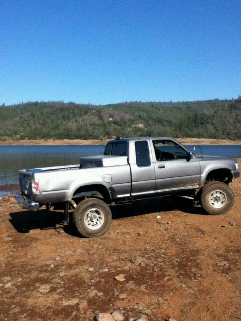

Hi guys I have a 94 ext cab, 5speed, stock v6.
Currently my truck has stock gears (4.10's) and 31x10.5 tires.
j would like to put some 33x12.50 mud tires on soon but not sure on what gearing. I run a lot of highway. But 1/4 of my driving is pulling hills. I was thinking 4.88 gears? I don't have to haul ass up the hills but I'd like minimum struggle to make it up
. What are your suggestions?
