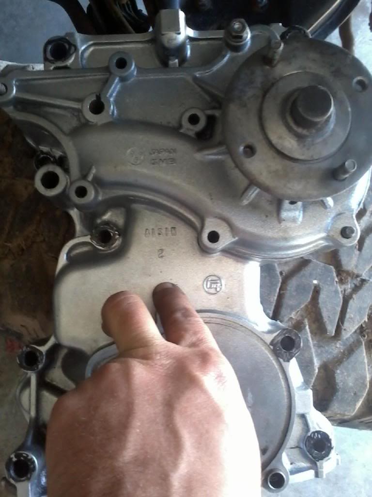

The way I tell an 85-95 block is on the passenger side you will have mounting studs for a fuel filter and around the oil filter will be a place to install a Knock Sensor.
If it has a factory Timing Chain Cover, below is what I have for information on Timing Covers.
Copied from my build thread.
84 and older. 22r has no dimples/circles and the number "2" on it. Twistedyota got it right on the height thing, see the last picture for a good example. I also tried to mark which bolt holes for removing the timing cover on down the road when I have to do a chain again. Hope it wont burn off but it if does I tried to come up with an easier way. Never can remember which bolts they are.

Here is what I am talking about on the 1/8th inch height. I used a lockwasher to help show how much of a difference. This cover is 84 or older. Seems like the oil pump bolts were to short. Hope this will save some one some trouble. It is an early model 22r timing cover on a newer 22 block.
