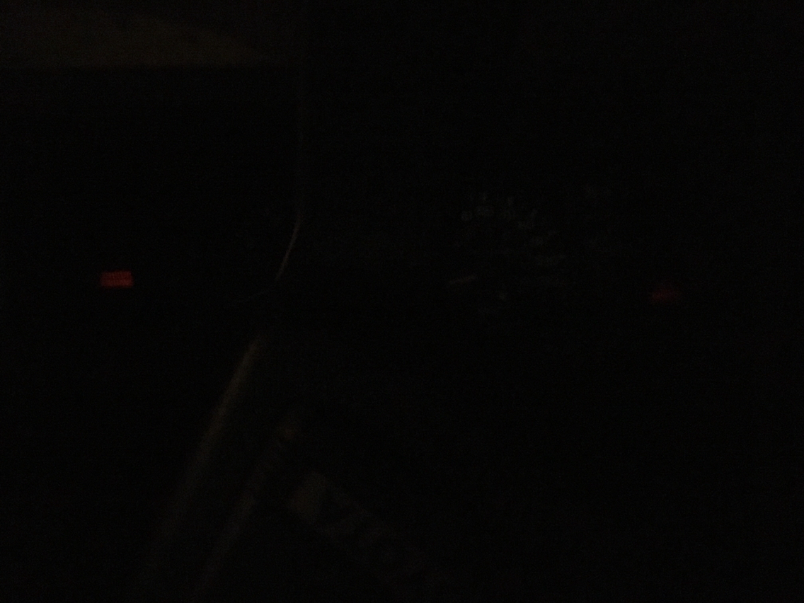

Ok new symptom. Now when I shut it off after trying to start it the CEL and Charging light stay on but very very dim. I tried to get a picture but it had to be almost black outside for it to even kinda show up. The CEL is kind of visible in the top left of the pic. You have to zoom in and look really hard to see the charge light in the lower right corner.
Any ideas of where to look for this connection. I did not mess with any wires and only played in the engine compartment. All wiring work has been done to try and fix the problem and has been limited to grounds.

Damn that is a good one. That is key off right? something is holding a charge and disipatting (capacitor), does it stop after a short time? Or there is a crossed wire connecting, it stays on and drains the battery?

Key is off for sure. I will check to see if it stays on all night after I try and start it today to move it. Won't run longer than about 5-10 seconds right now.

The cel should only be connected to power and the ECU, if you disconnect the ECU it should go out if it stays on its shorted somewhere in the cluster or dash wiring.

Charge gets a little complicated so, no offense, I'm hoping you find those two shorted together and lots of melted stuff in the dash harness..
Charge has power from IGN fuse on one side, then the diode, it joins the brake and at temp which both have diodes, and routes to the charge fuse and alternator L..
i do tend to over think stuff. Crappy contacts in the ignition switch. Some times they stick some times it's loose.. stuck partly you have power on IGN fuse, loose connection cuts ECU power
