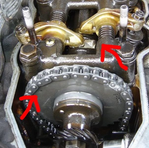

Right. Had that. Do I check inside the number 1 cylinder if the piston is all the way up, or it will be if things are duplicated as in this picture? Then insert distributor at 12:00 and it rotates to 11:00. All done. Put it all back together. Seems I've done this- but had no compression. I know I had it like this picture exactly though last time I put the motor together.

See how the lobe on the cam just passed the intake rocker and the dimple on the sprocket is coming around? With the crankshaft pulley at 0 that cam dimple will be about 12 o'clock and that's #1 top dead center compression stroke. At that position, begin step one of LCEs how to.

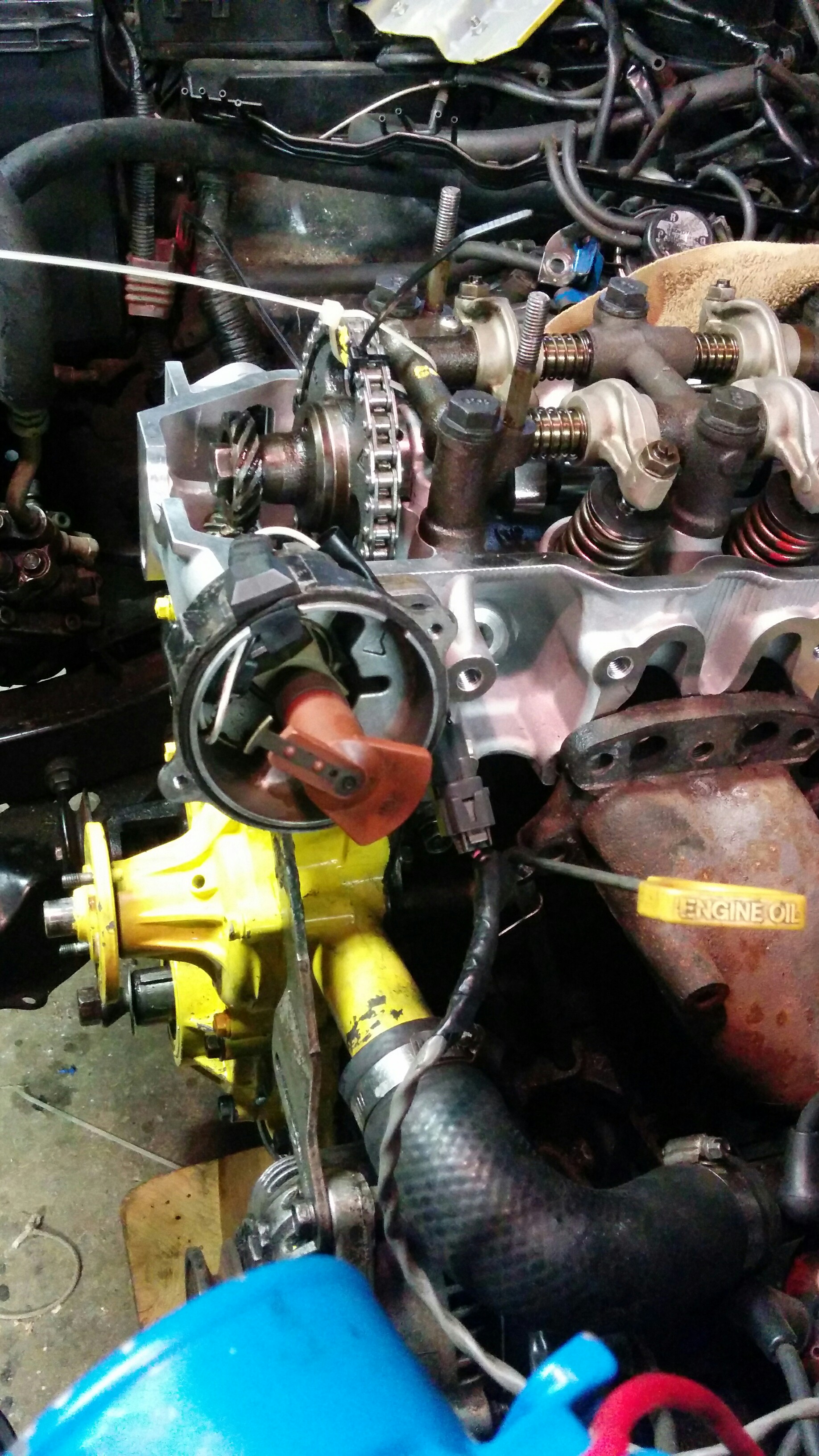

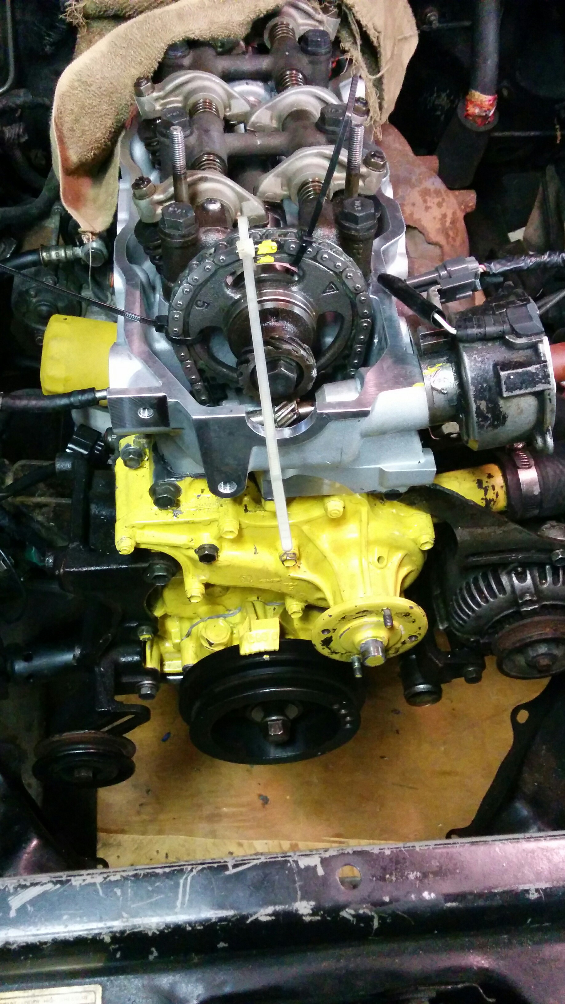

Mine lined up after four rotations. Still would like to know whether I did this right. Here are the photos of new head install on new motor with timing set. TDC on #1 piston is confirmed.
