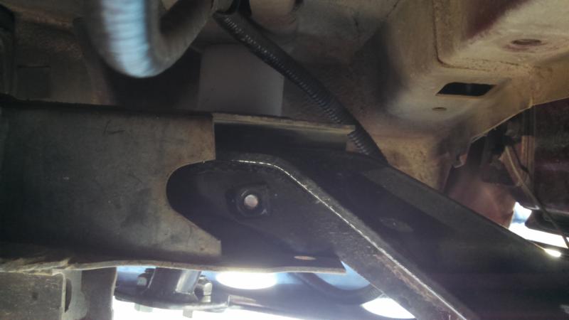

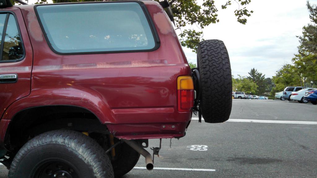

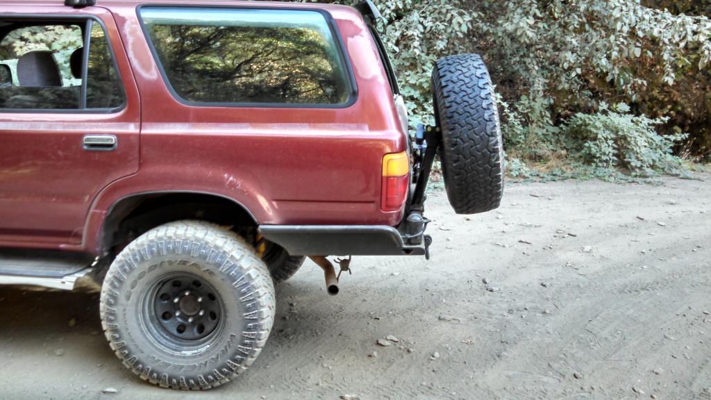

I went looking to see if I had any pictures that would be of any value, I don't, but I did find 2 that kind of show the BL in the background.
This is the passenger side rear-most body mount, that white hockey puck is the BL spacer that's sandwiched between the body and frame.
Then this is the driver's side (obviously) but if you look at the wheel well, you can notice a small gap between the body and frame, that's from the BL.
That corner now looks like this:
