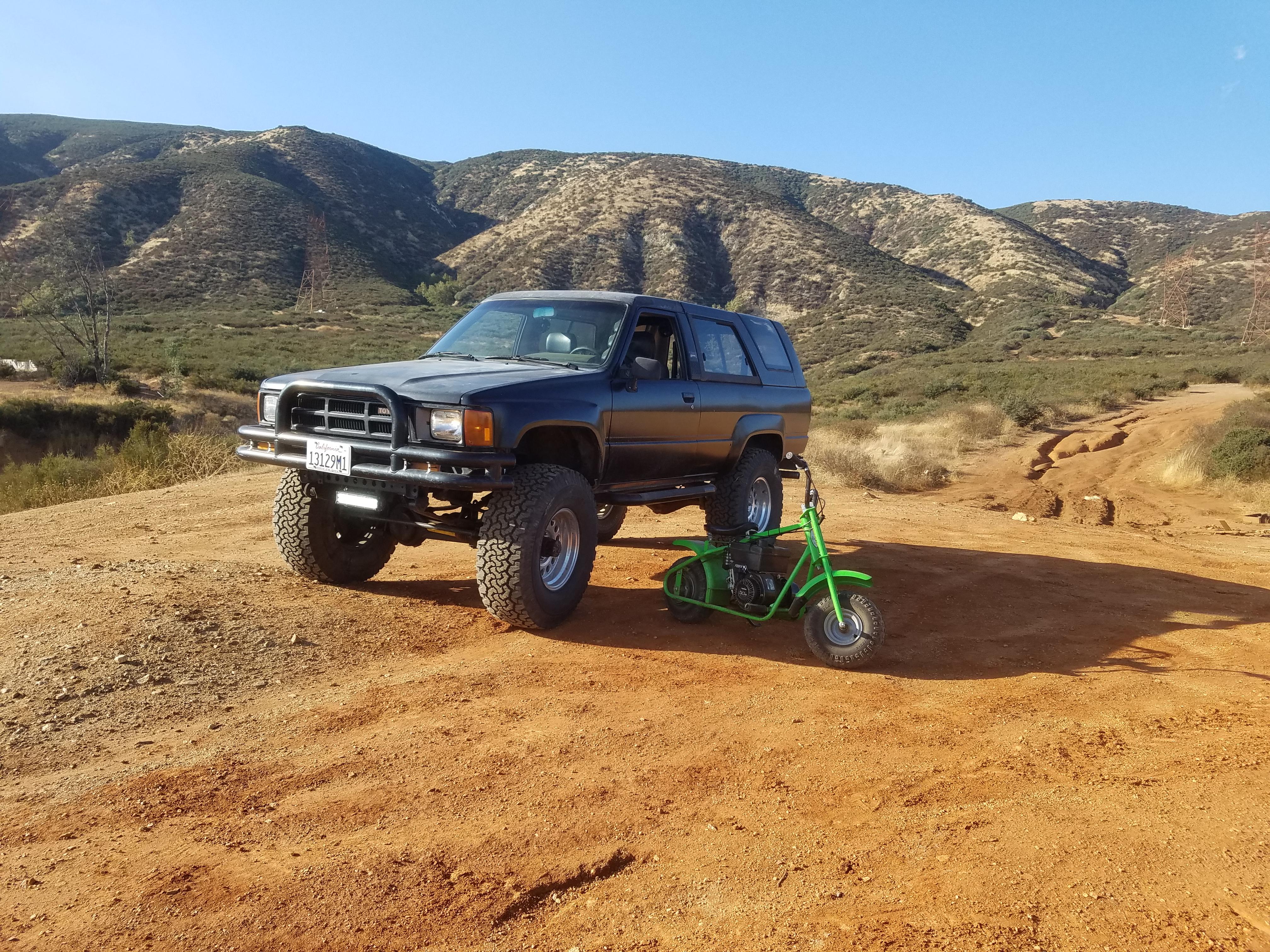

1985 toyota 4Runner w/ AC Heater
My truck has zero heat comeing from the core and Tryed bypassing the heater valve and there is still nothing and I wanted to know what I should do next, Do I just flush the core? and if so how? Any help would be very appreciated!
