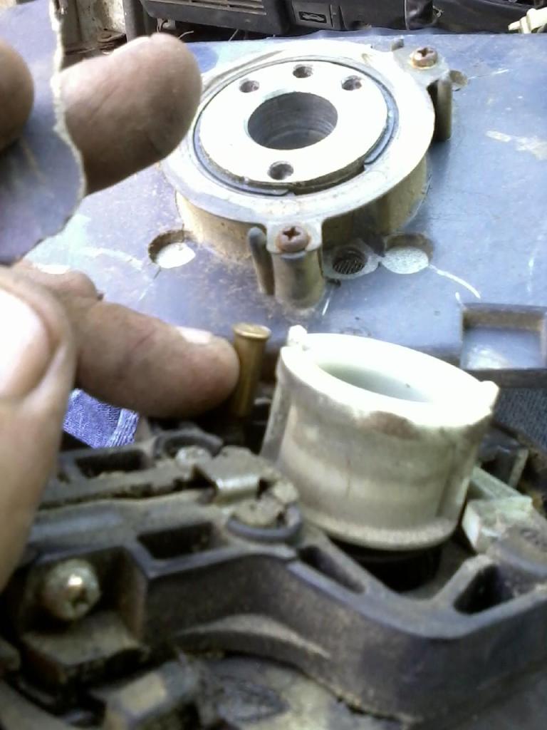

Here is how I fix my horn issue.
Got the horn to working. I used a .22 shell to make the contact to the steering wheel. I found this on Yotatech and like it better then how I used to fix my horns. I have it listed on my 88 4Runners build thread for more details about getting the horn to work on the first page. Will add this info at a later time.
