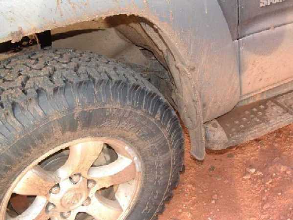

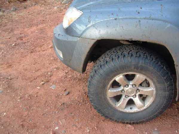

The ride is very nice, no real difference on the suspension except in the rear. It is a bit louder over bumps at high speed, like the cracks on the interstate. And, it is easy to over extend the rear shocks as we have to remain with the stock ones. We will have to find a shock extender. For now, not overdoing or just slowing down has avoided / limited this problem.
Also, I have been running with the stock 265-65-17's, so for the most part it is really the same ride. However, I just got back from dtc and successfully tried a new pair of shoes on - BFG T/A's, 285-70-17s. It will take a small amount of trimming but I should be back up there tommorrow to put them on for good. OD on these is 32.7" and gave a front fender meas. of 38 1/4". I like it.

FirstToy, Here are a few tire pics.
Attached Thumbnails 4th gen w/ XREAS and DayStar Lift-clearance-2.jpg
Old Feb 23, 2004 | 04:29 PM
Joined: Nov 2003
Posts: 40
From: Sedona, AZ
I know this isn't the right way to post these pics, but I can't figure out how else to do it!
Attached Thumbnails 4th gen w/ XREAS and DayStar Lift-clearance.jpg
Old Feb 23, 2004 | 04:30 PM
Joined: Nov 2003
Posts: 40
From: Sedona, AZ
Another....
Attached Thumbnails 4th gen w/ XREAS and DayStar Lift-front-shoot.jpg
