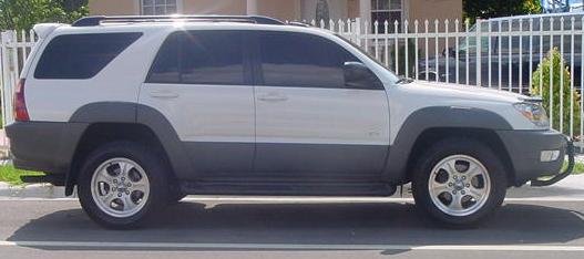

pics
Here are pics of the fogs and safari bar.

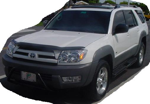

Front angle

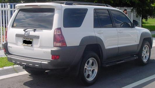

Back rear angle

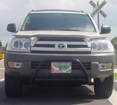

Front.

Yosman,
Where did you get the bull bar from. It looks sweet! I have the exact same SR5 as you (color and all). I'm thinking of going with the chrome bull bar instead. How securely does it fasten to the truck? Where should I go to get it and what can I expect to pay?

Safari Bar...
It's not a bull bar, actually it's a safari bar from westin.
I got the idea from someone on here after talking about that $500 plastic sport bumper. One member said that a bull bar was a little thick for the 4runner, and that the westin safari bar has tabs for aux. lights. So I went with the safari bar because it is a little thinner and had the tabs cut off. Touched up after the cuts with black semi-gloss paint and there you have a thinner bull bar. I know westin makes the chrome and the black finish. The tabs were not that long, about 1 1/2 " - 2", You might not want to cut them off. I got the black one since the running boards, tints, roof rack, and hood protector are black. I'll tell you what I paid for the black one, I am not really too sure about the price of the chrome one. I got mine off ebay from LongLewisFord. He had it for $120, plus $25 shipping, but I got him to lower the shipping to $15. PepBoys could order it for you they wanted $120 for the Bar and $40 for the mounting kit. LongLewisFord, includes the mounting kit and the bar for $120. I know he sells the chrome ones, and they have a website. (GoSaveOnline.com) Even if it doesn't show on the site just call the number on there and he can get it. Here is one of his post on Ebay.
http://cgi.ebay.com/ebaymotors/ws/eB...tem=2440062628
It says on there he has the chrome one for $215, but I would call and talk to him.
The mounting was easy it took me about 30-40 min. Two mounting plates that go on the front cross bar of the ladder frame, torque to 65 ft. lbs. The bar bolts on to the plates at 35 ft. lbs. Done. It seems pretty strong. My father stood on it, but then again he is a light weight skinny man. (estimated 150 lb)
Westin constantly does rebates as well. I didn't realize that when I bought it that they did so many rebates. The month before I bought it they had a rebate for $25 off the black bar and $50 off the chrome (mail in). The month after they had another for $50 off the black, and $75 off the chrome (mail in). So I would check Westin's direct website, under rebate. They may not update it but there is a phone # you can call that will tell you the current rebate.
Hope this helps.
