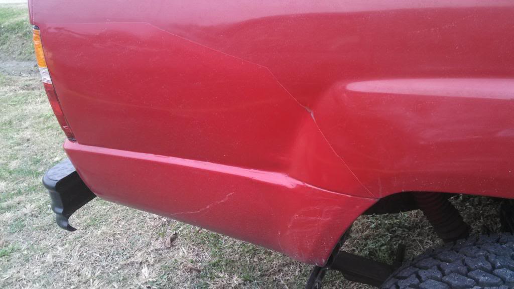

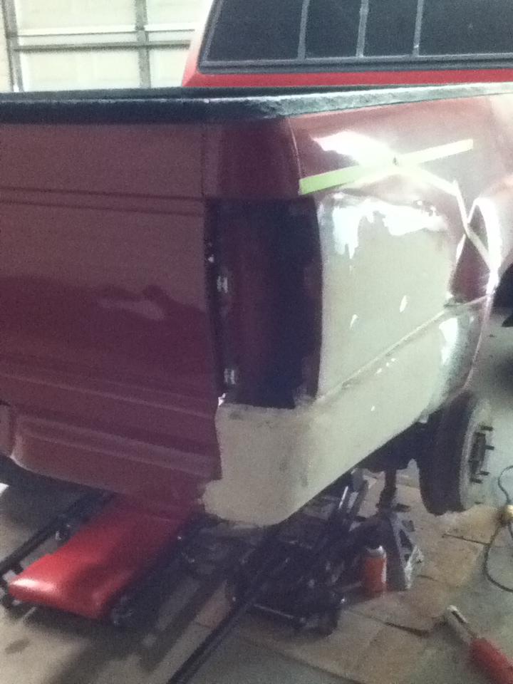

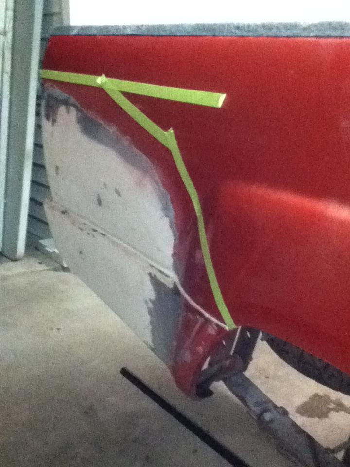

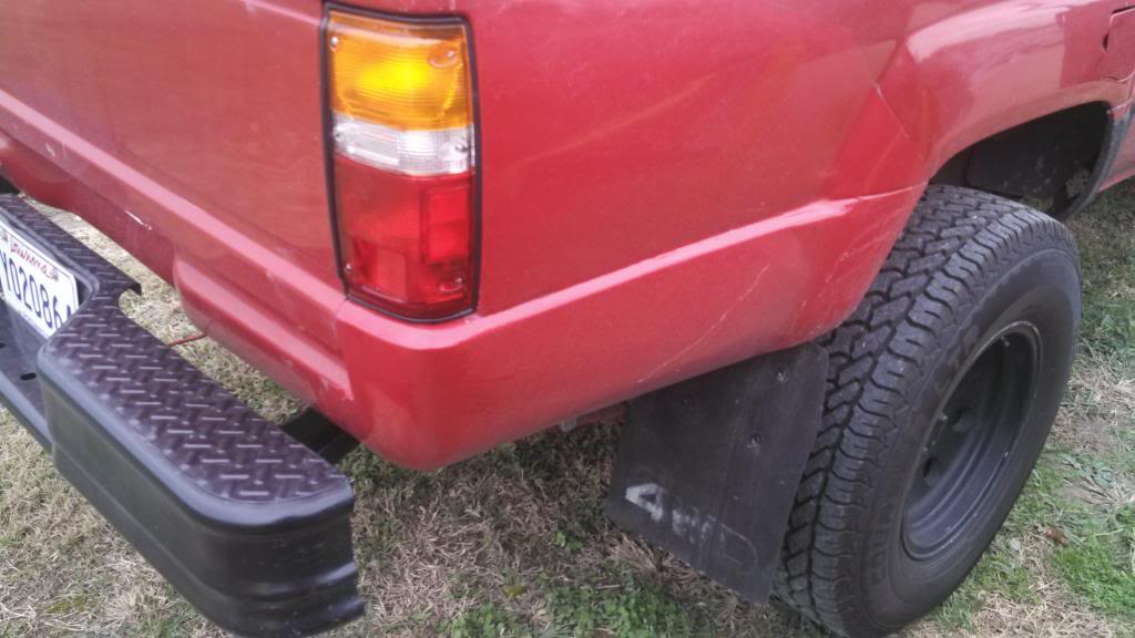

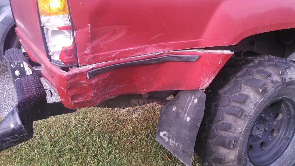

Well, I got in a fender bender and decided to do a little more work to the 88. I was hit behind the passenger rear wheel, and the shackle was bent slightly, so I decided to get some 7" shackles to replace the Zuk mod. This put me a little taller in the rear than with the zuk mod, so I also cranked the T-bars a little to get the front a half inch lower than the rear. I also found out that I didn't grind enough metal off near the ball joints, and that was limiting my up-travel on my passenger side.
I also replaced the 33x13.50 LTBs with 265/75 Mastercraft Courser LTRs (load range E). I don't go off-road enough to justify a M/T tire.
The ride quality has drastically increased, even with the load range E tires. It feels softer than my dads 1987 Xtra cab 4x4 truck, which is stock with 30x9.50 kumho A/T tires. But without the sway bar on mine, it wanders a little more. I could never get over 70 mph with the swampers, but with these I can easily get to 85 mph (on the speed-o at least). I like the gearing with 4.88 and 32" tires, it has balls in 4th and 5th gear.
I'll post pics later.
