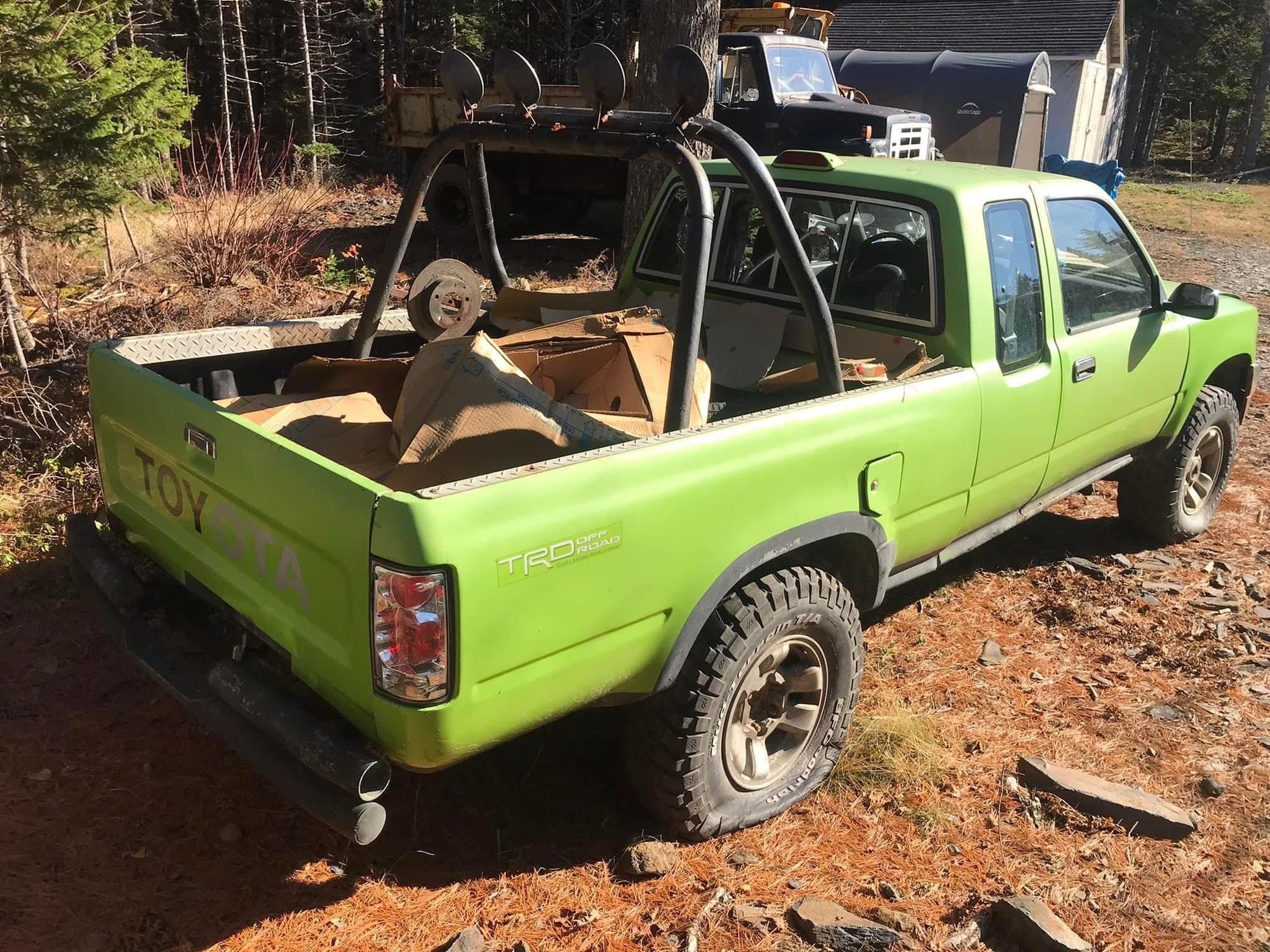

I have a 1995 Toyota pickup xtra cab. I bought it last year, it needed the basic things like plugs and plug wires. till i started to notice the frame was rotten. so I bought a donor frame and swapped everything over, and now I run into the issue of it not running. it cranks but doesn't start. iv'e went over the fuel pump and the rotor and distributor cap and cant figure it out. the truck starts off of starting fluid or when i spray gas into the intake. Also want to note that the fuel pump doesn’t come on with the key, only when you jump it via the diagnostics port
my 1995 Toyota pickup before the frame swap
