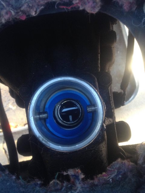

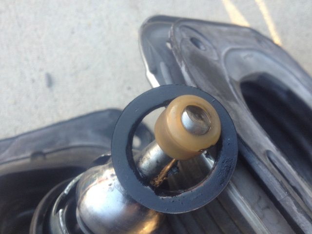

Hey, recently bought a new shift seat and bushings from marlin crawler to replace mine in hopes it will fix the grinding when shifting to 3rd gear in other than perfect rpm. My question is, is I followed their table for ordering pretty close I think and ordered the blue shift seat for the truck. Is this the right one?? I own a 1992 22re 2wd pickup.
old
Wrong Shift seat?-6ewxbl.jpg new
Wrong Shift seat?-smukjl.jpg Old bushing and seal

I'm pretty sure you should have got the white one for the tranny as the blue one is for the 2WD/4WD Low/High shifter. Your blue one looks pretty sloppy in there. On mine, there was a similar round gasket like you are showing, but the actual shift seat was almost totally disintegrated. The new marlin crawler seat replaces both old parts.
