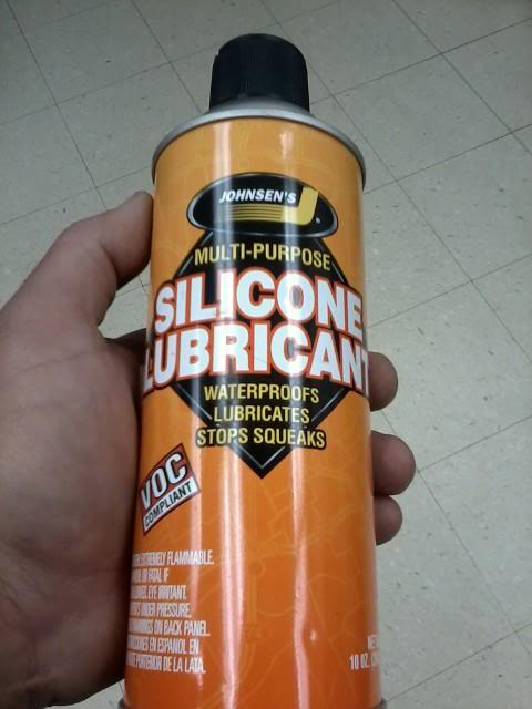

I have dealt with the glass jumping out of the rubber seal. Still have not gotten it completely figured out. At the bottom of the metal track that holds rubber track sometimes jumps out. I have tried gluing it down to help keep the rubber like it should be.
Another thing that is a big problem with the rubber is that it dries and causes friction on the glass and is hard to roll up or down. I have seen window cranks strip out due to this. Literally taking both hands to operate the crank.
Apply silicone to the rubber and work the window several times to get it penetrated into the rubber. I have seen it go from both hands to operate to just my thumb and pointer finger to operate. That does help to keep the window in the track.
Here is what I use on the rubber track. I am sure there are other brands that will work.

Thanks for the tips guys. I guess I'll try gluing the window to the lower channel. I have the windshield adhesive from work so it'll cost me nothing other than time. Everything from the regulator looked fine so I didn't wanna replace it if I didn't have to. My driver side is tight but it's manageable with a helping hand on the glass. When I pull the panel on that side again I'll grease it all up.
