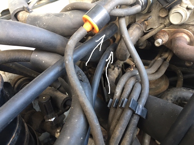

And does anyone know where these vacuum lines are supposed to attach to? Previous owner just has the ends of these laying in engine bay with bolts in the end of hose to plug them.I showed this to the guy at the shop,whether he told his mechanic or his mechanic saw them I dont know,they never mentioned it to me and I forgot to ask them if they knew where they were supposed to go.Since they are right next to EGR valve I doubt mechanic missed them.

You most likely have some vacuum and electrical plugs out of place, there is a really good image here somewhere that shows the sensors and a color coded vacuum line diagram.
I thinking it is possible you misunderstood the explaination of the problem when you retrieved it from the mechanic, or just misremembered. Might they have said something like "an exhaust valve leaking".
Get the vacuum and electronics sorted. Then do the suck test, a piece of paper held close to the exhaust pipe if it gets sucked back it's an exhaust valve leaking. Someone will hopefully correct me if I am wrong but I don't think the PAIR system will give a false reading right, maybe it the reed valve is stuck?
Look at this thread. for picture of the vac hoses.
https://www.yotatech.com/forums/f116...1995-a-297077/

Thanks,now I know for sure those 2 hoses laying in the engine bay with bolts plugged in them go to the power steering pump,which I wouldnt think would be that important but who the f knows
I think they just cause the engine idle to increase when you using power steering, so no, I do not think they would be that important. Folks block them off when they break the valve on the power steering pump.

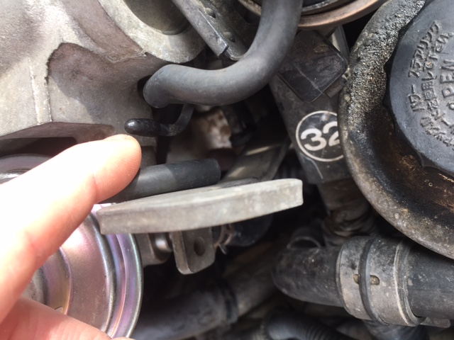

Went ahead and bought new distributor also.I'm just going to bypass the egr either with the kit or another way and concentrate on fixing the misfire.What is the difference between using the block off kit and just hooking up resistor and just pulling vacuum hose off top of egr valve and blocking it{as seen in pic}

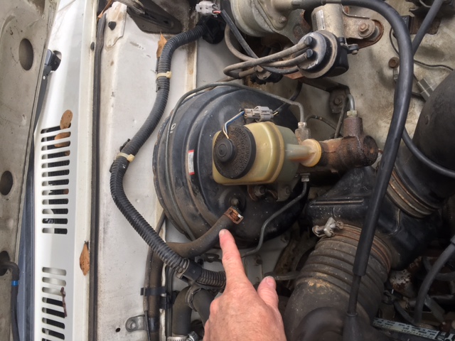

And on a separate note,I bought this kit http://www.youtube.com/watch?v=Mw7W-...TBeSLScaVdkdHQ
To do step 2,would the best place to do it to would be this hose coming out of the brake booster?
thanks
exhaust pressure forcing the valve open with out the help of the vacuum modulator. Due to a weak spring or high pressure.

OK thanks for the reply but not the answer I'm looking for. What I mean is can I just run it like that or do I need to put the block kit on it?
there must be some reason for going to all the trouble to block off those ports as opposed to how I am doing it now so I am wanting to know what the reason is, does it hurt the engine? Or just bad performance? Thanks
can you yes, should you no not if you suspect it is compounding your issue. (As explained above if it's there and has an opening it can and will still open, can be come stuck open ect. All the reasons people remove them and use the plates.)
Yes even a perfectly functional egr valve causes damage to various degree's based how the rest of the engine system is operating, it does lower exhaust temperature when functional which is good but at the same time it's putting carbon into the intake which is bad.
Pretty sure I mentioned above to just use a tin can to for a solid gasket to determine if it's the cause or just adding to the problem. *Shrug* last I remember is you performed some work and it got a, you need to get it back to at least running as well as it was originally to continue debugging that issue or your just going in circles IMO
