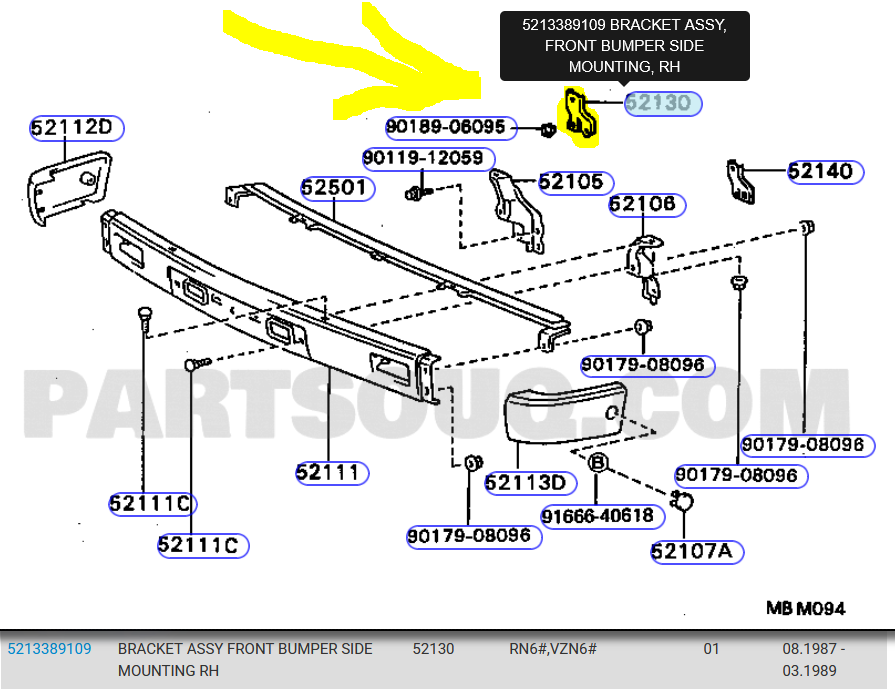

I'm not familiar with that particular part, so I don't know what it actually does, but I'm gonna guess it's this:
52133-89109
BRACKET ASSY, FRONT BUMPER SIDE MOUNTING, RH
It only appears on the 8/1987 to 3/1989 front bumper & bumper stay parts diagrams.
In other words, there's also a 8/1983-8/1986 and a 8/1986-8/1987 version of that front bumper parts diagram, and they don't show those brackets or anything substituted in place, so seems like something that got added later in production.
Link to PartSouq parts diagram for a VZN61 (1st gen V6 4Runner)
