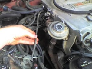

what is this VAC TUBE...
It's pluged up because if it isn't it runs real rough...
Where does it go to?

http://personal.utulsa.edu/~nathan-b...74layoutan.pdf
That one (I think) goes to one of the 3 VSVs mounted on the PS wheelwell. Check the link, it might help.

its either the VSVs or your egr vac hose. In your picture ur egr isnt even hooked up!

OK now I feel stupid... That tube goes to where it says it goes in the scamatic. trouble is I had some tube backwards but I fixed it. Basically the VCV for the EGR was going to the charcoal canister not to the vac source. So I incorrectly assumed that the EGR valve was blown when in fact it's VCV wasn't getting vac, so I disconnected the EGR valve. I've since reconnected it.
Here is the problem. Look at the scamatic. You'll see that the charc canister has a tube that goes to the TVV for EVAP (what in the world is that!) UNDER the pelum. I wiggled my fingers all over that $%^&* and can't find it!
SOMEONE HELP!

Anyone knoew where the TVV for EVAP is? If you look at the scamatic in the second post you'll see it located below the pelum, but I couldn't find it. It's the tube that goes to the charc canister.

ok... I found the TVV for EVAP located under the plenum. Turns out that the nipple to take a tube to the charc. canister is broken off. Is there any performance detriment from not having the EVAP properly installed?
