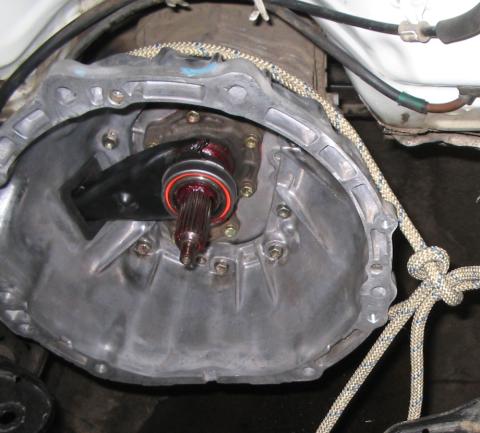

The purple Castrol stuff works great, but just so you are aware it's supposedly not good for aluminum. I use it just the same, but just make sure to rinse well. Here's what my bellhousing looked like after I cleaned it with Super Clean.
Attached Thumbnails What / how to clean the inside of bell housing & back of motor?-img_0934.jpg

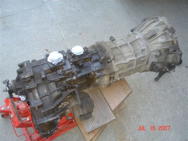

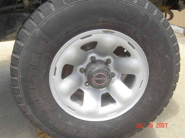

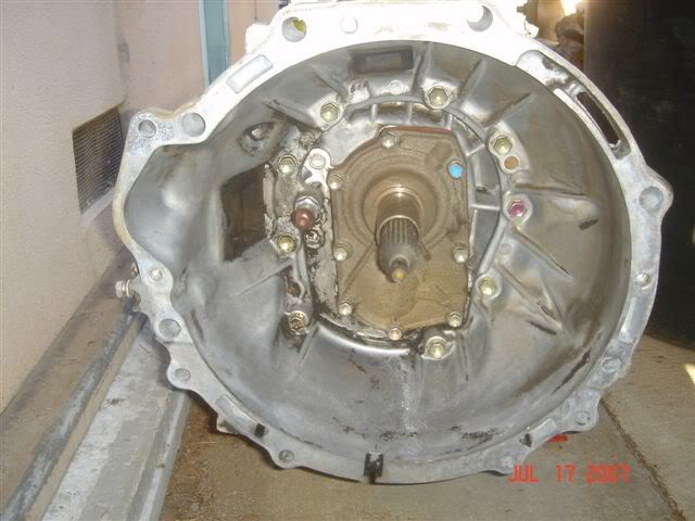

Ok, so I found the same stuff, just packaged a little differently out here on the Left Coast? Worked great, thanks for the TIP! I also used it on the stock painted steel rims and then pressure washed them to strip the paint off and it worked pretty well! Got 90% of the paint off with one app and the pressure washer. Then sprayed them up with some Hammered finish silver, looks much better!
Here are some Before & after pix of my tranny and the painted rims?
