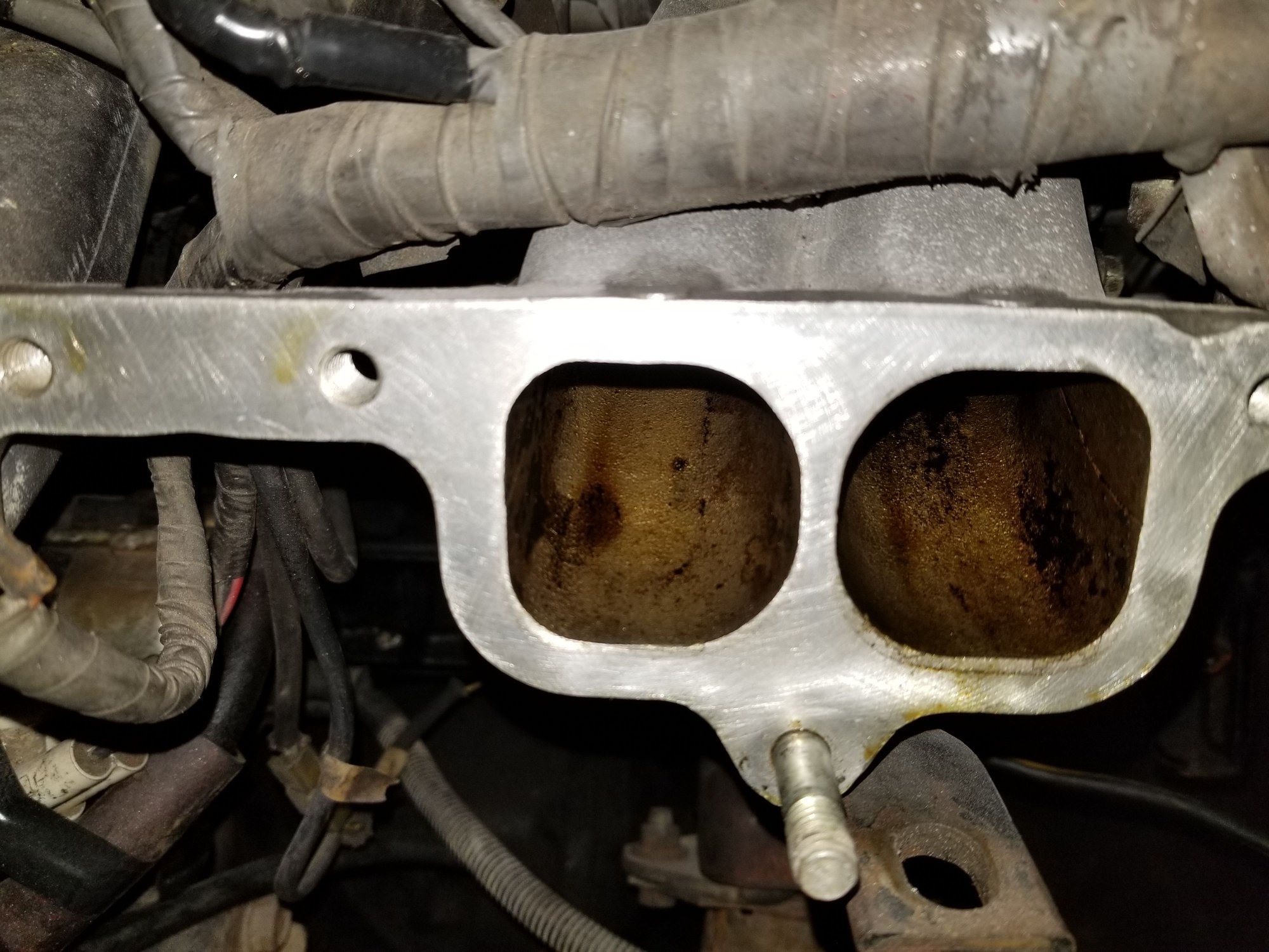

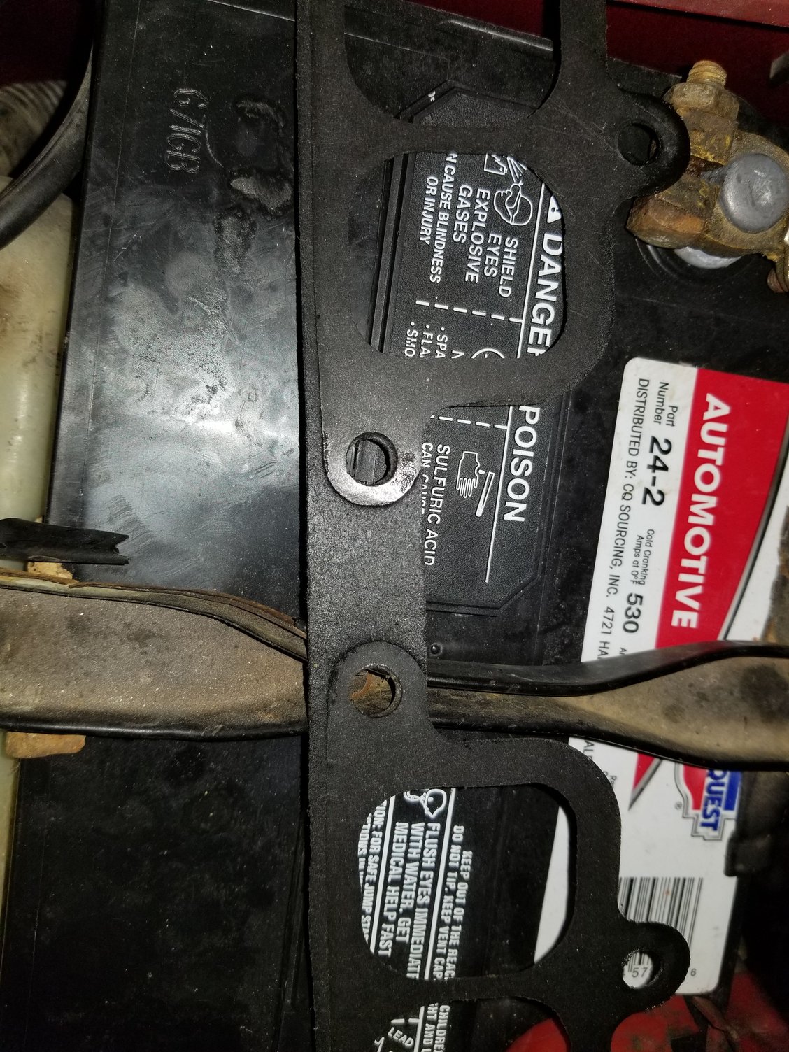

Interesting find with the manifold off. The upper intake gasket is soaked in fuel in between runners 2 and 3. Which doesn't seal anything. Tells me there is an external leak. I have smelled fuel from time to time driving it but have never found a leak.
there is also a bit of fuel puddled in runners 1and 2. 3 and 4 were slightly wet but not puddled.
i ran the fuel pump with the engine off for about 5 minutes and there were no leaks that i could find. I then immediately pulled injectors out and no fuel sprayed. It leaked out of the rail, but definitely didn't spray like i would think if it was holding pressure. I'm lost as to where this fuel is coming from.
Raw fuel in intake runners 1 and 2
Soaked with fuel in between runners 2 and 3.

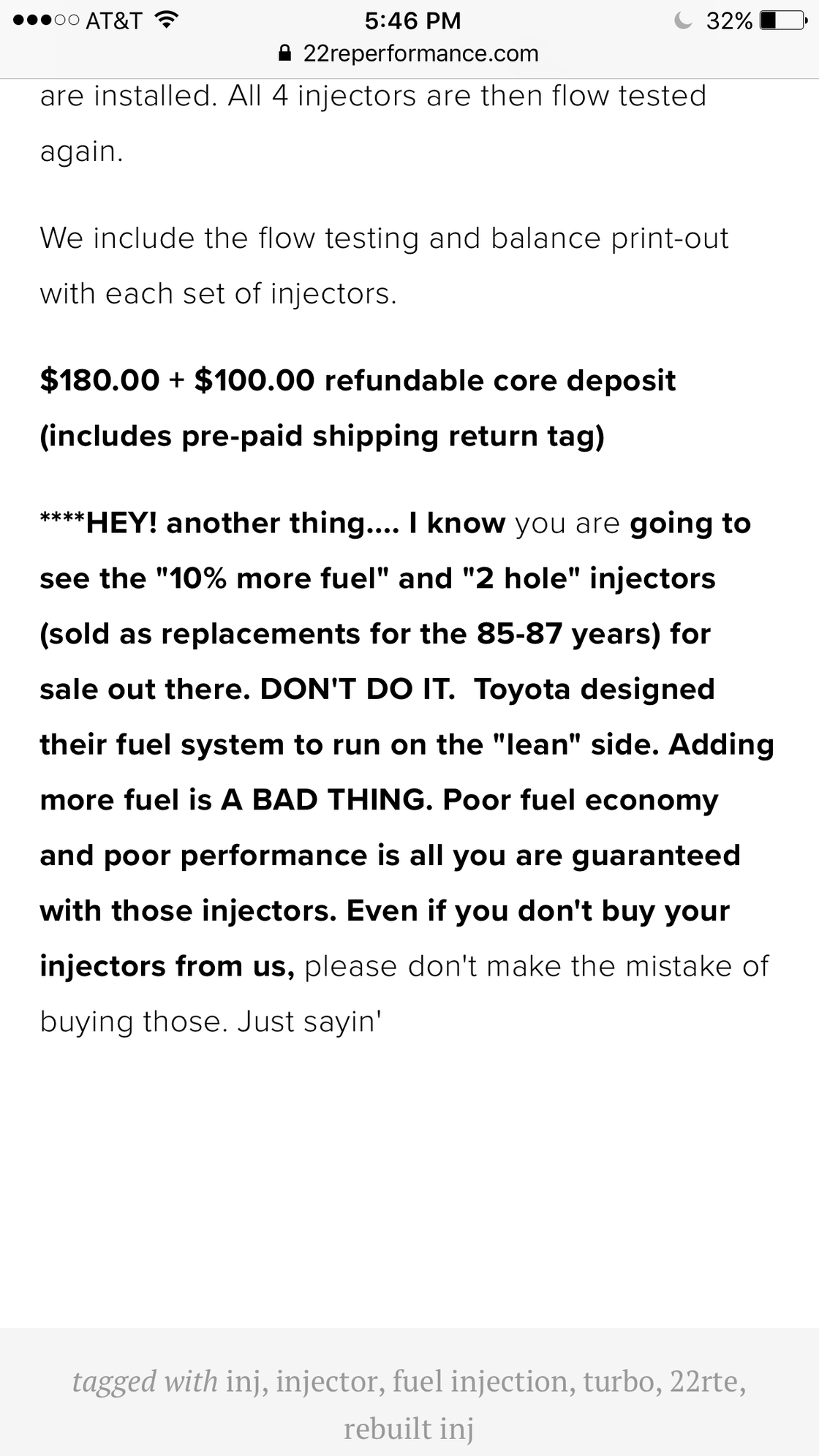

For whatever it's worth here is what 22reperformance says about aftermarket injectors.

They are "supposed" to be the same size injectors, meaning no extra fuel. That being said, who knows what they are at this point.
I only bought them because one of the 4 originals was not original, it's some weird looking thing. I may have to buy a set of originals if i can't figure it out though.
I replaced the crush washers last night, injector o rings, and cleaned out the fuel rail and double checked my wiring for my injectors. If it continues then i will proceed with further pressure testing and possibly changing out injectors.
