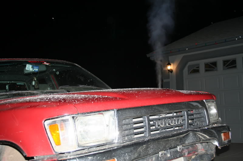

thanks for the reply's and i apologize for posting this, i should have looked around more as well as more research...but im just kinda tinkering with the 3.0 just for fun, but i have a V8 350 SB with a few mods done to it, puts out about a good 420 horse, thought about swaping it into my truck from the camaro..but might as well sell the camaro with the engine...and as for my truck right now, its got some timing added to it, NX purge kit, CA intake, 80 series flowmaster mufflers, cat and stock muffler MIA. But thanks again thanks for the reply's.
