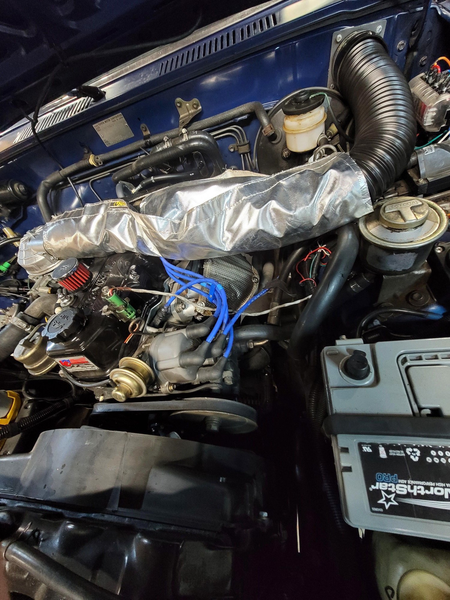

I didn't really like the LC K&N open air cleaner setup, seems like a really dumb design, unnecessarily difficult to remove for tuning / adjustment, and if you're running an LCE header underhood temps are rather high...if you're still running the air injection system even more so. As I had blocked the path of the stock air intake for a second battery by the time I decided to ditch the LC air cleaner, I've been working on a cold air intake through the cowl. Seems to work good, but I've still got some heat shield fabrication / improvements before it's what I would call done. I don't think you'll lose much HP going back to the stock unit; if it weren't for the second battery that's what I would have done.

oh nice set up, im guessing the heat shielding is for tht part tht goes over the exhaust manifold huh? Yeah I have a Headman header on my truck, wrapped it once, never again lol. That hat on your carb was something else i was looking into, but I wasn't sure where to route the filter to. What kinda filter are u fitting under the cowl?

Yeah, that photo was a little old. Here's what it looks like now. The header is mostly covered. Still wanting to build a spark plug wire tray / heat shield to cover what's left of the header and clean up the wrap on the intake. The filter is the big stainless cylinder in the older photo, covered up in the newer photo. https://www.spectreperformance.com/a...filter-housing. Works well with Spectre 3" flex hose and and the Weber hat. It's working fine, but I wouldn't really recommend unless you don't have any other options.
