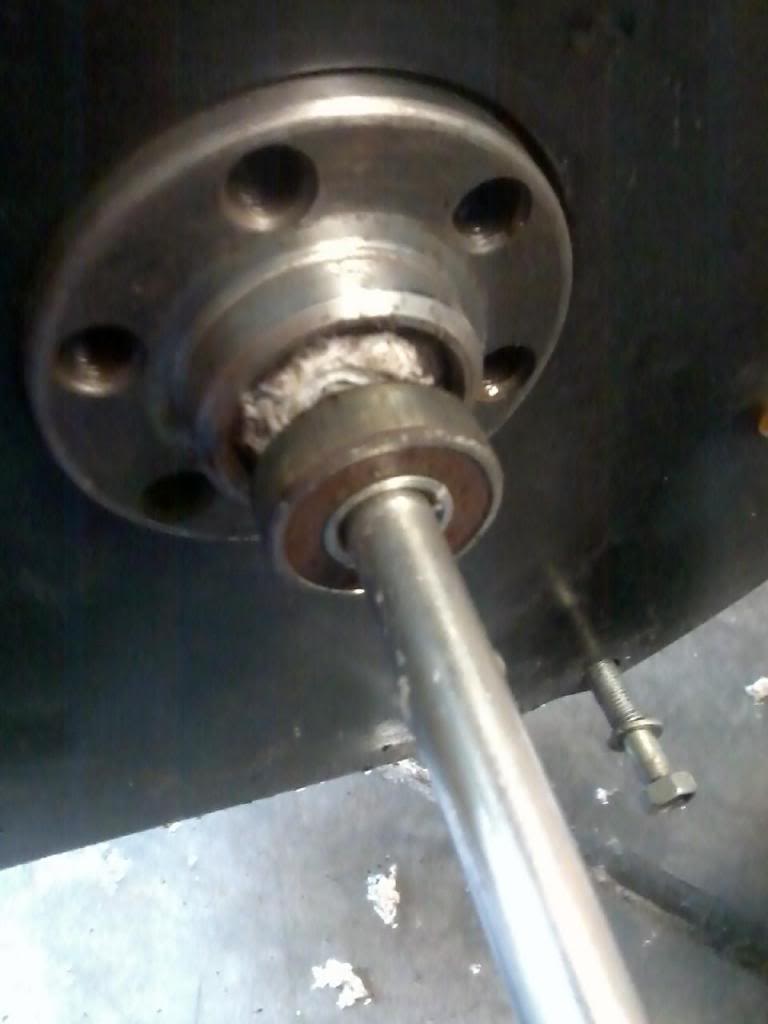

Removing the Pilot Bearing. Filled with pieces of wet paper towel and drive it out with something the size of the bearing hole.

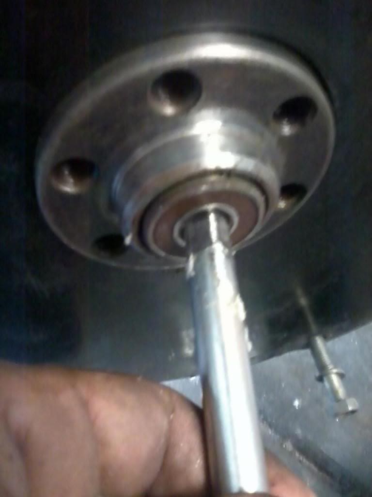

Here it is out. Can take up to 2 sheets of paper towels.

Well guys thanks again for all the tips! Clutch replacement went fairly smooth with the exception of a few hiccups. Turns out my pilot bearing exploded! I can't believe it worked at all! The only thing left was the outer race and a bunch of shrapnel that used to be the bearings. I also had significant play in my throw out bearing. I ordered a new clutch kit from low range off road with a new flywheel to boot.
