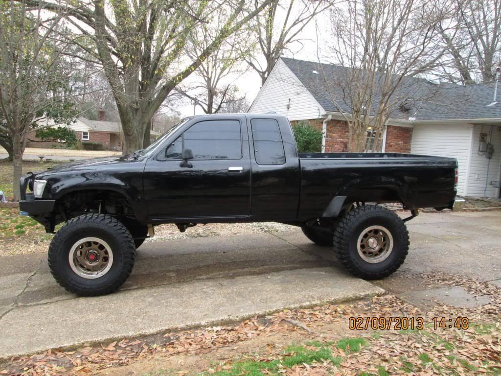

Found an old thread from almost 10 years ago. Took some digging, but looks like at least someone did it successfully.
https://www.yotatech.com/forums/f108...v8-sas-265255/
this is the only definitive photo i could find...
Dont know if this needs spacers or machine work though...

Looks like I found my answer:they will fit, no wheel spacers needed, but you will need to cut the inner lip off to allow it to fit over the locking hubs.
Tires used are 265/75 R16.
Thanks to @Shiryas for posting his work. Cheers!
