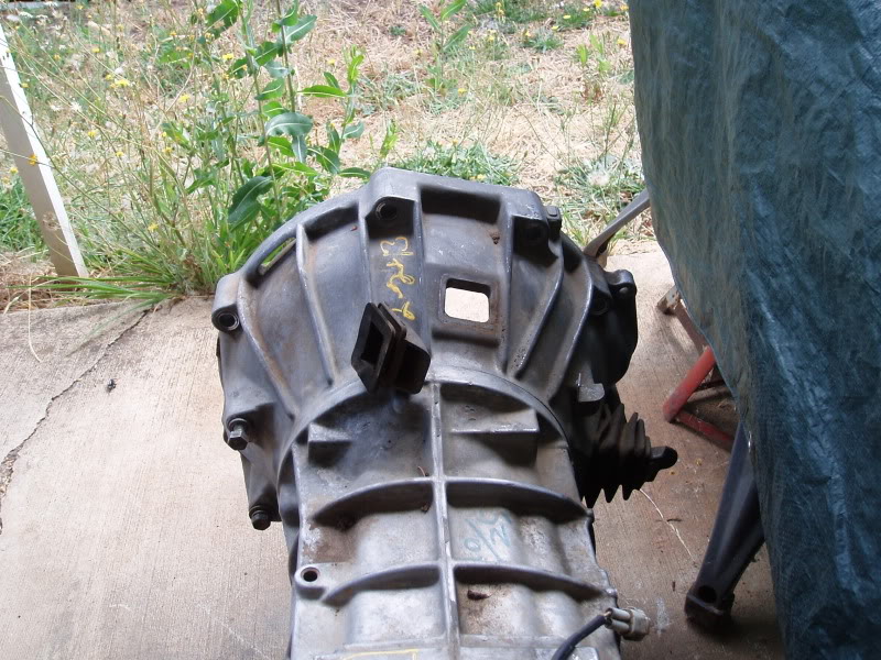

Originally Posted by tried4x2signN
There's a vent on a manual tranny? That's new by me...
Bellhousing vent.
Transmission & Transfer Case Breathers and Shifter Boots.
