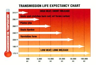

Well, I finally got my tranny temp gauge installed. Pics later today. Does anyone know what the operating temp is supposed to be for these trannys?
Old Aug 9, 2006 | 07:54 AM
  #50
mt_goat's Avatar
Joined: Nov 2002
Posts: 10,666
Likes: 5
From: Oklahoma State
Hope you can read this chart it's from this Amsoil page: http://www.performancemotoroil.com/t...ion_fluid.html
Attached Thumbnails Transmission cooler mounted behind grill (pics)-life.jpg
How did you mount your gauge?
I mounted it on the shift console with a universal $20 mount from Pepboys. When it gets cooler in 2 months, I will install the tranny cooler. Right now it slowly works its way up and past 180 degrees driving around town....on the highway at 75mph it stays at 170. The precision is un-matchable....minor increments are every 2.5 degrees on the faceplate.

My temp fluctuates from about 180 at freeway speeds up to 220 on steep grades or bumper to bumper traffic on hot days. I can easily get it up to and probably past 250 if I tried. I've learned how to keep it cool by turning off the OD on steep grades. When you turn off the OD I think the torque converter locks up so it cools down pretty quick.
My tranny getting pretty old so it's probably not normal.
