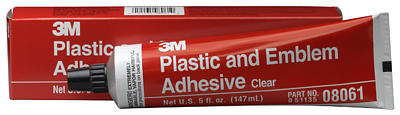

yes you did...but how do u attach the emblems after half of ur 10 yrd old adhesive remains attached on ur vehicle. is there any other way to reapply them if ur old ahesive is just too messed up

3M products work

silicone
duct tape
screws
rivets
3m adhesive automotive trim tape

does the 3m adhesive stuff melt when it gets hot out, just dont wanna go out one day and see my emblems slidin down my truck.
